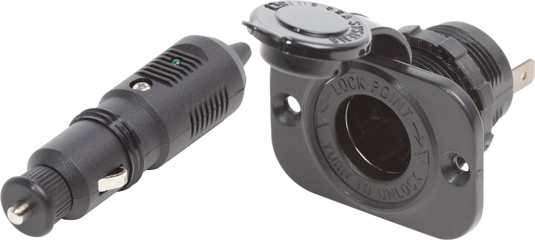

Ok on your post I went and looked. I have to buy a male connector, female connector, socket, plate housing, and crimper and they are all very pricey. Why is this better? It doesn't look better.
I use this kit for my fridge. Enough of a catch that the plug stays plugged in while also compatible with other cigarette plug based accessories.
12 Volt Plug with Dash Socket - Blue Sea Systems
Got this in. It's not twist lock.
It seems like it will work well enough to not bother sending it back, but it simply isn't twist-lock. I mean, it's labeled as such, it just isn't in practice.
Oh well, it's at least better than a typical cigarette lighter outlet.
The photo on the website clearly show it as a twist lock, it appears the arrows need to be aligned for it to be able to twist and lock, are you sure you have the plug aligned with the arrows properly...or maybe they sent the wrong part, does the socket have arrows on it???
Nah that twist lock is malarkey. It definitely holds better than a normal cigarette lighter plug but it's more like twist-unlock than twist lock. I sat with it in my hands several minutes messing around with it and it doesn't appear to have the mechanism for a true twist lock like you would see in a industrial socket.
Oh well.
