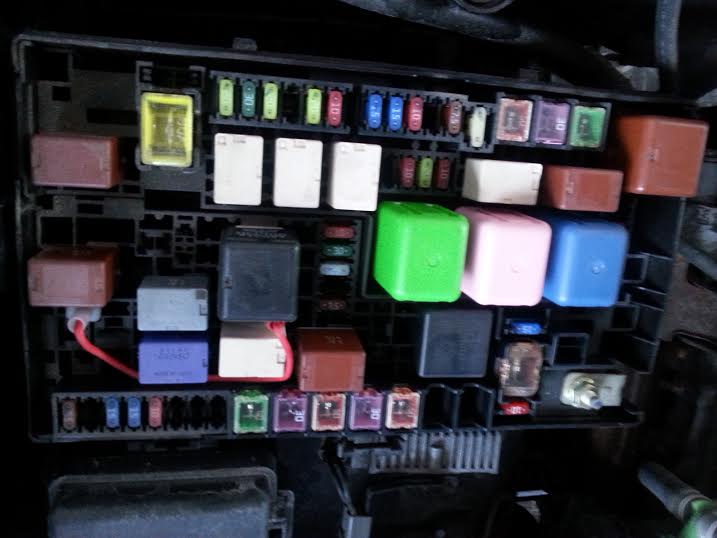

Theres is a easier method, if you dont want to disconnect the battery, look in the engine fuse box, youll see a white jumper fuse link, just take that out and go inside and turn on the lights so you can discharge all the stored electricity, then about 30 mins, put that jumper fuse back in and see if the check engine light remains off.
OK, which one is the jumper fuse???
Update, pulled the jumper last night and reinstalled this AM.
The only thing that disappeared were my radio presets, trip gauges and mpg, mph and mte readings...
VSC lights still on.
Did the ZPC and the VSC lights went off, OBD arrives tomorrow along with the O2 sensors. Fingers crossed!
