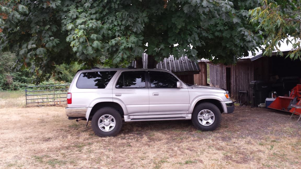

right now, sitting on the level ground im at 36 inches to top of wheel well opening rear and 35 front
265/75/16
thats not a reliable measurement -tire size can change that. the best way to measure is center of hub to top of fender well.
