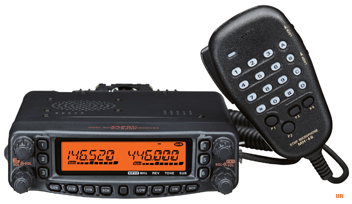

Yaesu FT-7900R mounted under the driver's seat with the faceplate separation kit and mic extender. Faceplate mounted in modified sunglass holder and mic mounted next to right driver's leg.
