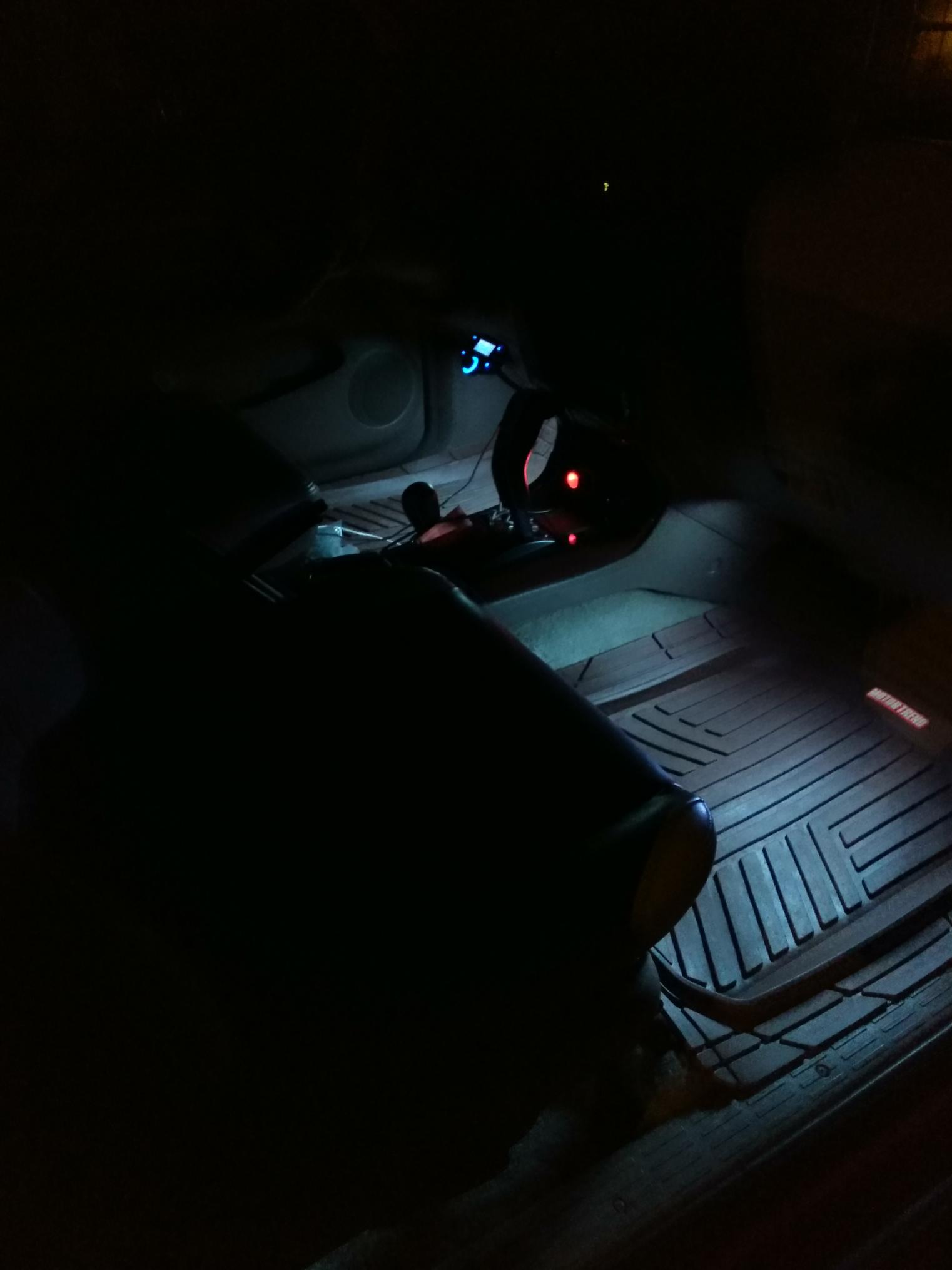

I put these in all my vehicles, Red for my Runner.
I figure why recreate a wheel - these are awesome - 4 lights - one set of wires - plug to lighter or wire to a switch of your own (so you have Something to contribute), all kinds of light colors and change options.
Can't be built for less than this costs either...
Amazon.com: Govee Interior Lights for Car, App Control Smart Car Lights with DIY Mode and Music Mode, Waterproof LED Interior Lights with 2 Lines Design, RGB Under Dash Car LED Lights with Car Charger, DC 12V : Automotive

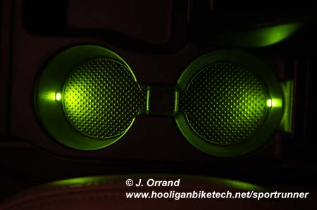

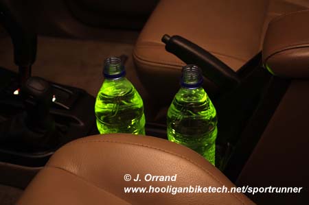

[MENTION=8729]Speedy[/MENTION] The cupholders look great! I'm looking to add lights there and also maybe an ambient from the the ceiling and prob another in the cubby behind the cup holder. What LEDs did you go with and did you tap into the cigarette lighter wire? I'm about to buy some green or multi-color set of 3mm flat tops, or maybe round
Edit: Just found the link to your homepage, brilliant site you've got.
Thanks, be sure to check out the Project Sport Runner play list on Youtube. Might give you some ideas for projects. 3rd Gen 4Runner Project SportRunner - YouTube
You can use about any 5mm LED for ambient lighting. The thing I always focus on in making it look OEM and work like OEM (no switches or anything plugged in to the cig lighter).
You'll need some resistors to get the brightness right and that took some trial and error for me to get them dim enough to be "ambient".
The original cup holder lights were 5mm green LEDs from Radio Shack that I built a custom harness for with resistors to match brightness. However, I recently replaced them with some Oznium bolt LEDs in 6mm. WAY better, high quality, and much easier since they're pre-wired for 12V systems. I did have to add an add'l resistor to dim them, but that's easy. I tied in to the +12V wire that powers the ashtray light and grounded them to a bolt under the cup holders. Keep in mind to put connectors on them so they're serviceable.
Bolt LED: Amazon.com: Oznium Brightest Light Bolt - Flush Mount 12V LED Light for Bumper, Grille, Cars Interior, Dash, Ambient Lighting, Motorcycle w/Sleek Aluminum Housing & Screw Nut (6 mm Black, Cool White LED) : Automotive
