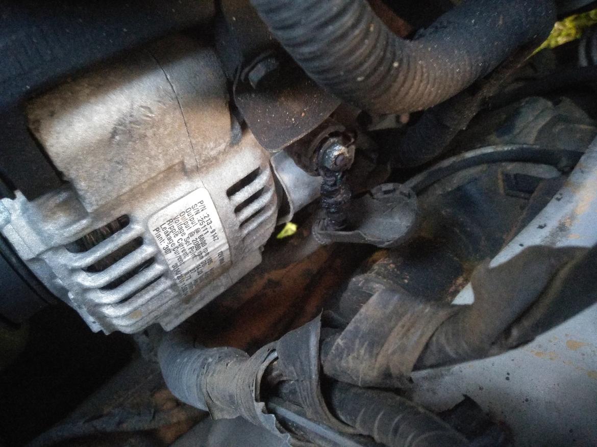

Well, I may have found the potential issue (besides the incorrect fuses being used) to the burned wiring. I was just checking under that hood and I have paperwork stating the previous owner replaced the alternator at Goodyear (WHY!!). The alternator is not even close to being OEM and prob the WRONG DAMN ONE. The connector on top is BURNED and the wire going all the way down. The battery that is in this truck is a size 54 or something. The WRONG BATTERY SIZE too. WTH were they thinking. Now I must REALLY do the BIG 3 by default LOL. I will REPLACE the alternator with the CS144. May as well right?

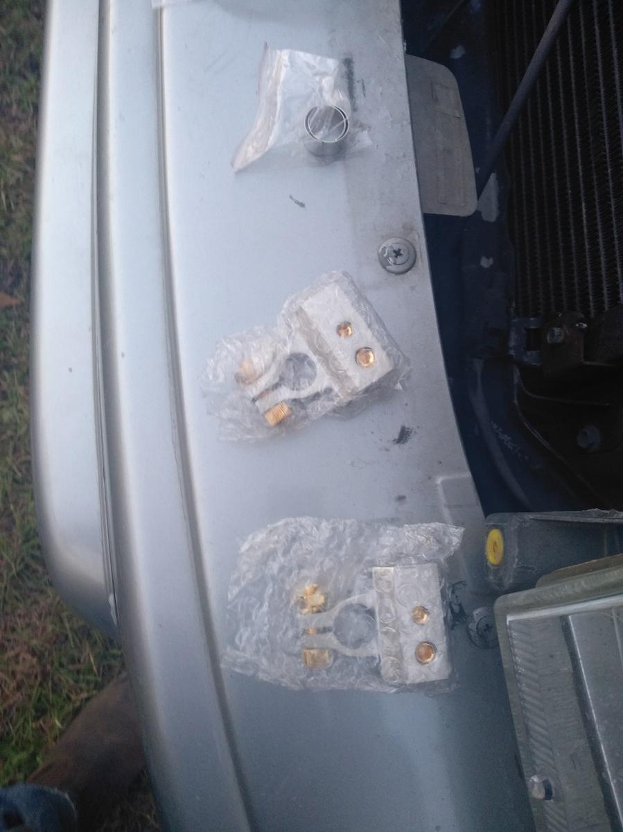

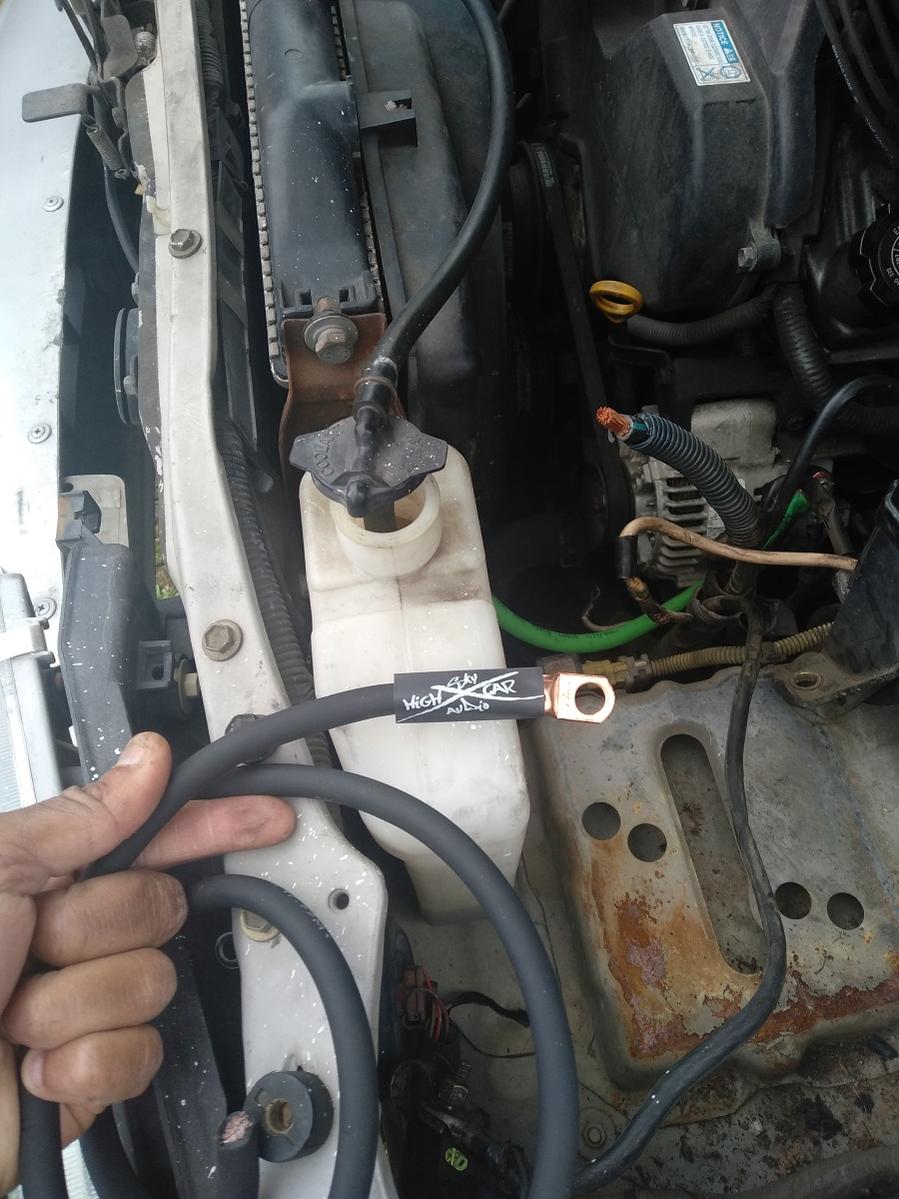

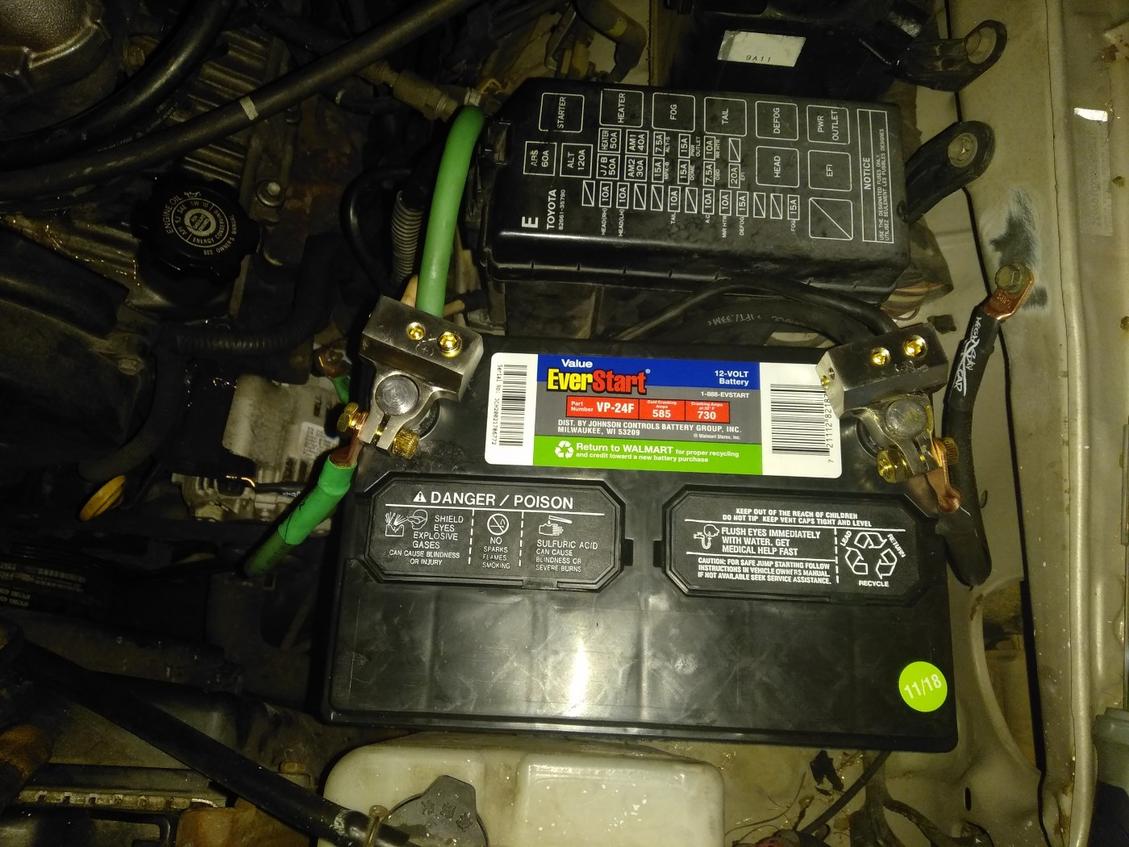

I directed my attention back to the engine compartment. I wanted to make sure the wiring was going to be good when I fired her up so I got a new battery, changed batter terminals, and installed the BIG 3 (4 gauge kit ) from Sky High Audio!! I would HIGHLY recommend their kits and the big 3 period.

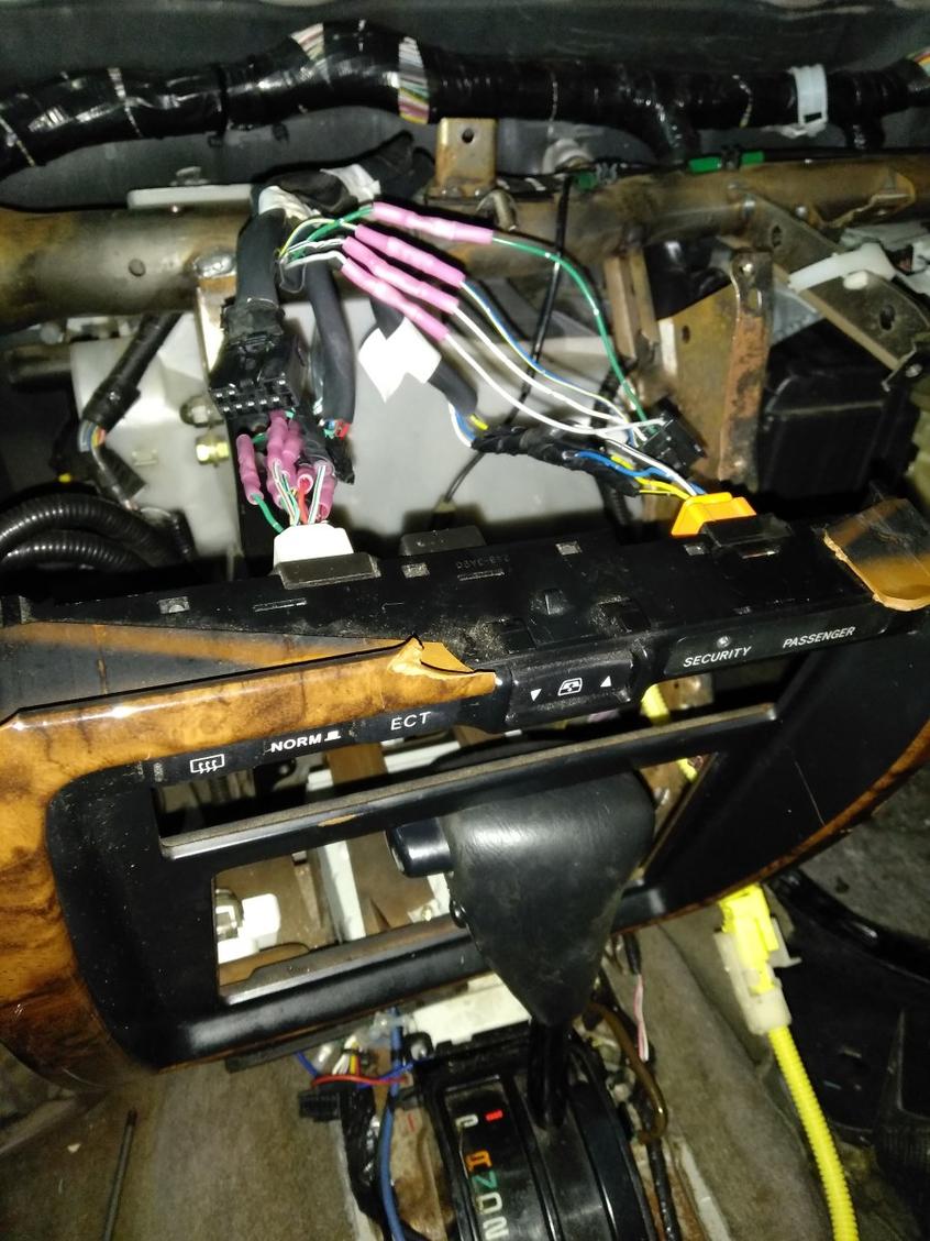

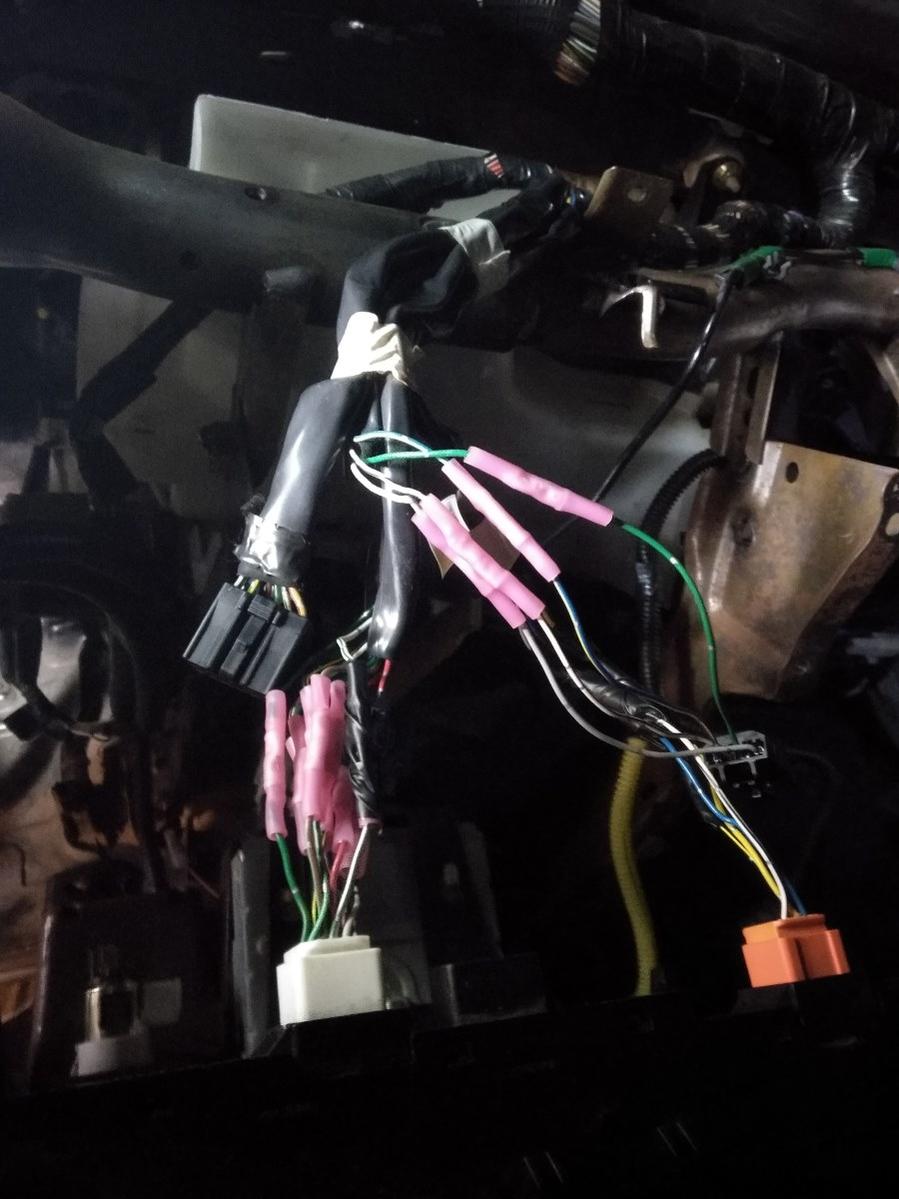

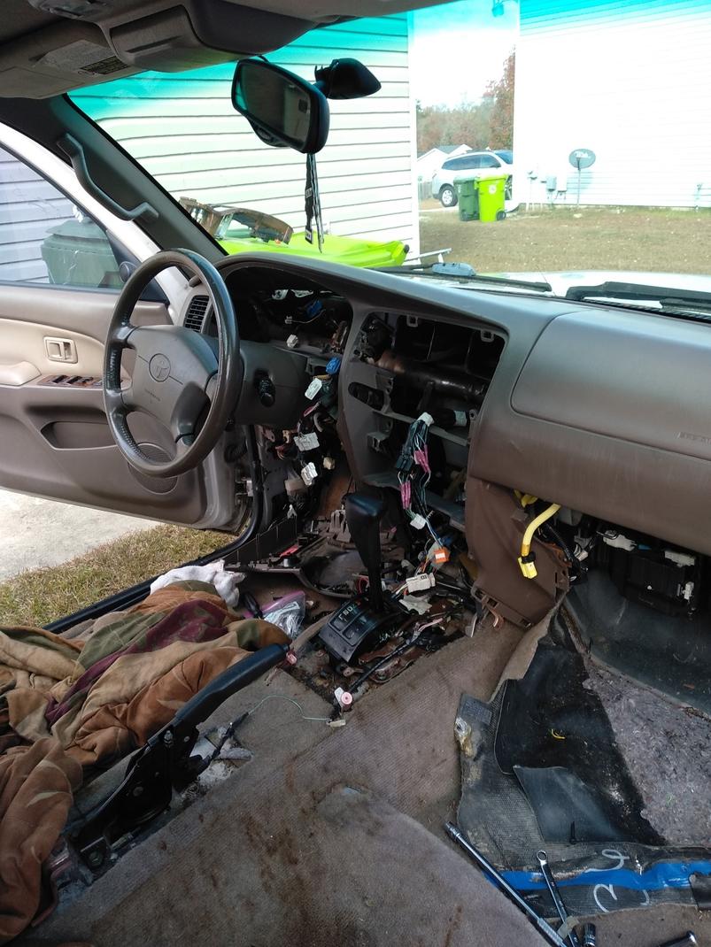

I located another 3rd GEN limited and me and a buddy decided it would be smart to get the ENTIRE wire harness instead of me soldering like I was about to do before as there would have been more headaches than needed (not pictured). I was able to put everything back in including replacing my bad blower motor (JUNK YARD FINDING of course). Some DOH DOH cut the wires to the harness I picked up that goes to the ECT, Security, Rear window, etc... Luckily I did not trash the old one. I just but connect/heat shrunk them from the old one (WHEW). Still NO LUCK finding the woodgrain radio bezel :( This again was the condition of it when I purchased the truck. SUX!!!!
