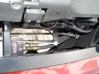

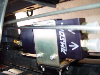

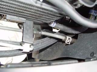

Koz, this is a very nice installation. :cheers:

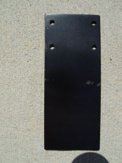

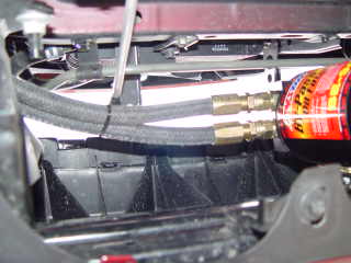

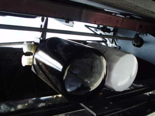

Can these filters be seen from the front of your truck or does the whole installation stay out of view behind the license plate? Also, specifically what metal is the mounting plate you used made of?
Thanks in advance. Lou

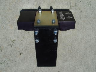

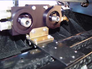

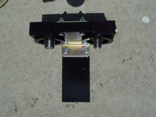

The system can't be seen. The front plate conceals it, but to change them you can just reach behind the bumper. This location is perfect and looks stock; even the hoses match the trans cooler hoses. I used steel for the mounting plate because I had it lying around. I would have used aluminum or stainless if I had some. Just make sure the thickness is at least 3/16".
Koz

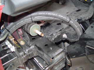

Just make the mounting plate up (3"x 7.5"x 3/16") prior to installing. You will need a right angle drill, 7/8" crow's foot (to tighten the hose ends at the filter block), and stainless rivets. The pictures and write-up should help. If you have any questions feel free to contact me. I check this site daily (weekdays).

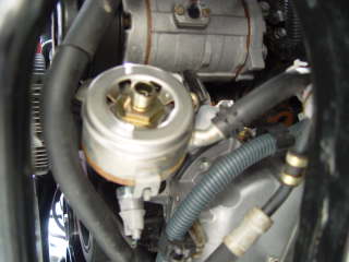

I removed the bypass system at about 300,000 miles because of the proof of filtration by the Amsoil EAO oil filters being so good. Comparing the hard to find filter dimensions chart I found a larger oil filter that fit.
If you have access to the Amsoil EAO oil filters, the bypass isn't needed.
