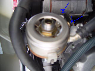

Koz, do you see those two plugs that are next to (not part of I don't think) the oil cooler/filter housing... what are they for?
If you could use a photo editing program to indicate/point to which plugs you are refering to, I may be able to tell you what they are.
Koz
Koz, you have me green with envy!
BTW, here is a picture - the two plugs are identified by arrows. I'm feeling a bit HIGH STRUNG so I will apologize for the arrows not being neat.

Also, from what I can remember those plugs arent a part of the engine oil cooler assembly itself.
I really didn't take a good look at the sides of the cooler, but it does look like they are right on the cooler. If I were to guess, they are for some sort additional system or just a drain.

Koz thanks for responding.
See, this is why I thought you were going to instal the BMK 15 by using the Amsoil PLUG to cap off the original engine oil filter cooler/ OEM oil filter mount) and use those "in and out" plugs to get the fluid to and from the Amsoil filters.

I'm still stuck on those plugs (so please bare with me as I need closure). Now, lets say those plugs are in fact a pressurized "in and out" for the engine oil, would it be wise to add an engine oil cooler that is a radiator type (like the trans fluid radiator).
PROZAC said:
Well, I am going to buy this setup and use your excellent write up.
I really don't think an additional oil cooler is necessary; the V6 & V8 are not that hard on oil. Synthetic oil itself runs 10 to 20 degrees cooler then conventional oil. Also this bypass system acts as a cooler; especially having the filter mount in front of the radiator. The billet filter block has to dissipate some heat. With this setup I think it
