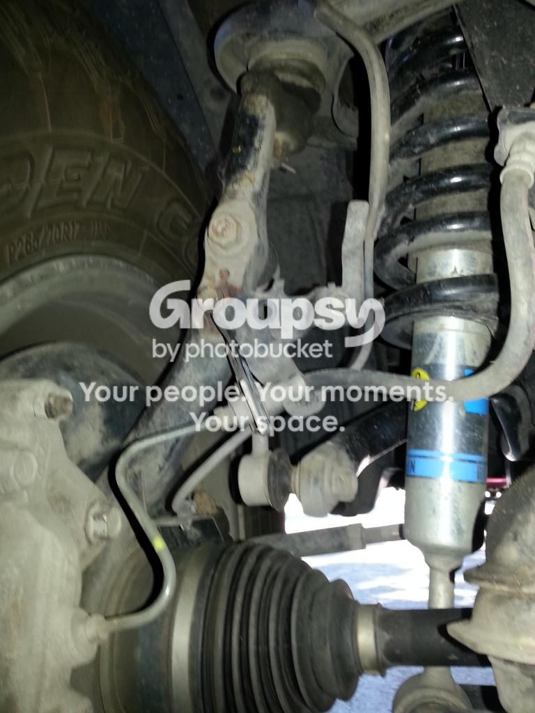

Hey man. I recently re-did my brakes as well, and afterwards have noticed a rattle on the driver's side on almost any bump - usually but not always on sharp, quick hits, and definitely on bumps. It was driving me crazy, making me nervous since I did my own suspension, and I was following this thread hoping for an answer.
Anyway, I finally went underneath today to test out my exhaust heat shield and noticed my brake line was not re-bolted on to whatever connects the upper control arm to the wheel (that description tells you how mechanically inclined I am). Anyway, please don't be insulted, but thought I would check since your rattle sounded similar and it also started after doing brakes. Worked for me!
