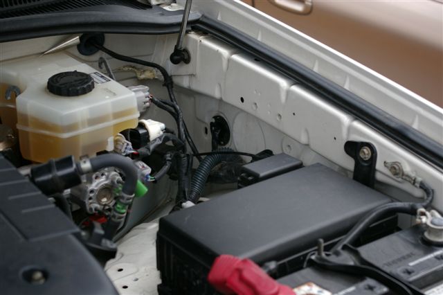

Here is a picture. If you notice there is a black plastic disc just below and forward from the hood lift on drivers side. Pull that out from side wall. I located it from general discussions and placing my finger in the circle against the buzzer while pressing remote lock/unlock buttons. My first pic upload. Hope it works and helps...

Great photo. Thanks very much for indicating the location of the piezo. Today I removed it from that area, taped a bunch of paper towels around it and just secured it beside the wiring harness. It's very quiet now. Wayyyyyyyy better.
