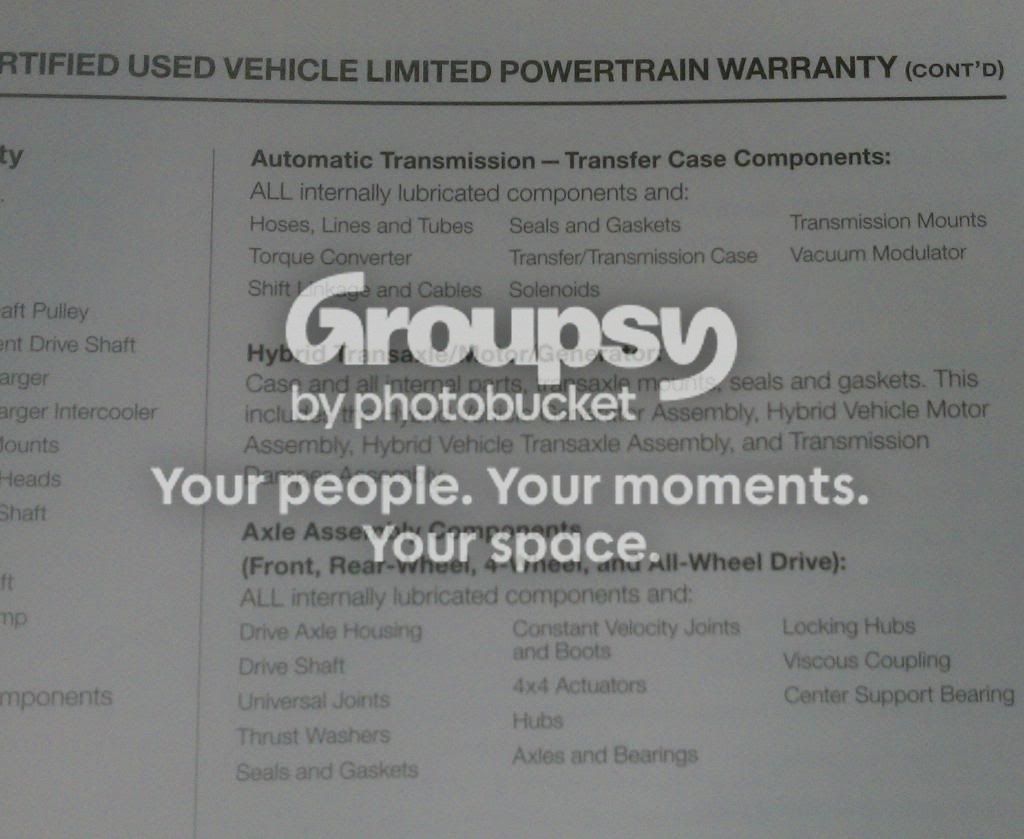

if your dealer is giving you the run around on warranty repair for this issue
warranty.jpg~original
I think with 84K on it he's SOL.
