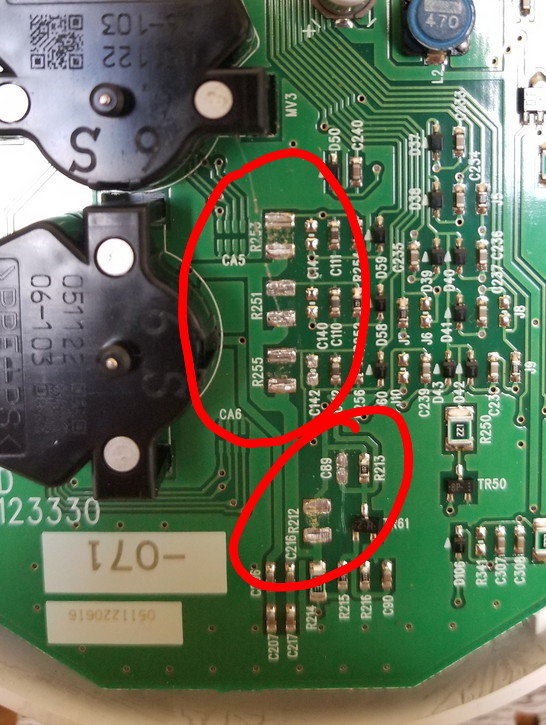

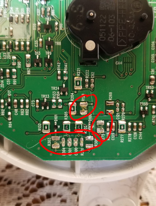

Today I pulled apart the dash. It's not good. The idiots who had this truck did a lot of damage to the PCB. There are at least 14 components broken off. Here are a couple pics.

I'd give the dealer a chance to make it right. Then a chat with whatever state department regulates dealers and repairs. Very not ok. Pretty sure they'd be on the hook.
Also while that is totally repairable, I'd try to get them to replace it first.

This is actually a very easy thing to fix and it's going to cost about 250 bucks. It's really not that big of a deal, just annoying that someone would be this dishonest.
