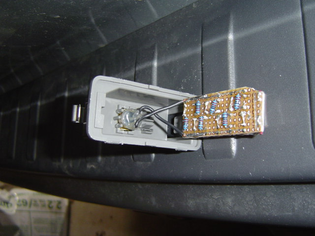

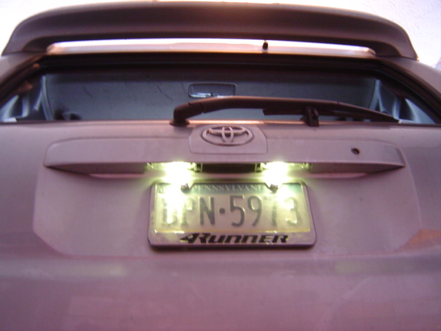

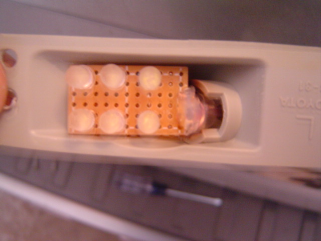

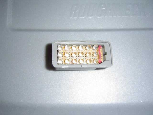

Instead of trying to cram as many leds into the small wedges purchased from autolumination, I decided to use what we had available. If you noticed when replacing the door lights and the license place lights, there is a lot of wasted space in these bulb housings. What I did was cut a perf board to fit the available area and mounted the leds to this, using the led resistance calculators found all over the web. Since I used warm white 5 mm leds, I could place 3 leds in series with a 220 Ohm resistance, which draws about 15 mA. Once the leds and resistances were mounted, I ran a positive and negative wire to one of the empty sockes and used that to replace the bulb. For the door lights, I needed to leave enough slack in the wires to be able to plug in the socket, and then *fold* the perf board in the housing. For the license plate lights, I glued the socket to the perf board at the same angle found in the housing for the license plate bulb, so this one plugs right in. Check out the pictures and I'll do my best to answer any qeustions that you have. I have also done this with my running board lights as well,but keep in mind that I added the lights to my running boards so I am not familiar with the stock running board lights.

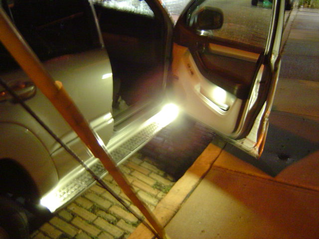

Door and Running board leds...
Talk about bright, and an awesome idea. I'd want to do this to my interior lights as well, but i'm no experience on soldering or led electronics and stuff, i'll probably learn or something.... They are so bright though, i'd love these on my truck.

The dim stock lights were the motivation that I needed to find something brighter. I tried the Krypton wedge bulbs, with no real difference other than being whiter than the stock bulbs. I also tried the matrix led bulbs, but they had a bluish-purplish tint to them and looked really bling-bling. I like these leds a lot. They are classified as warm white, but look much better than the super white,which tend to have the bluish tint. These bulbs have a yellow tint, but they seem to be just what I was looking for.

Cool lights, I like your door ones the most. I've 5LED Matrix bulb there, it's brighter then stock bulb, but not as yours. Man, your door lights looks like projectors.

Yeah, they have some nice output to them. I like the brighter lights, especially in front since the map lights don't illuminate when the door is opened (as discussed in numerous other threads). They tend to provide more than enough light!

I haven't given it too much thought on using the 1W or higher LEDS, primarily due to cost and the need for a heat sink. I haven't even experimented with them to see how much heat they give off, but from what I hear, the heatsink is a necessity. Given that those housings are almost completely sealed off, I didn't want to risk melting anything. Also, keep in mind that my configuration allows every 3 leds to be in series drawing around 15-20 mA. For the Door lights, I have 6 series circuits in parallel, therefore I am drawing about 120 mA. I could be wrong, but I believe those higher wattage leds actually use around 350 mA, which is higher than the stock bulb current draw. If anyelse has done something similar using higher powered leds or if my line of thinking is incorrect, please chime in.

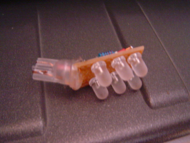

Oh yeah! Much more light than what anyone could cram into those small wedges. So we're on the same page, those leds are a 5 mm warm white and have an ouput of 12,000 mcd @ 20mA. I am driving these leds anywhere between 15 mA and 20 mA. So keep this in mind when looking at the pictures and the light output. You probably could spend more $$ to get higher output leds, but I am happy with what I have. By the way, I bought those leds off of ebay for about $20 after shipping for a package of 100 from the seller lckwtc. I like the warm white since they are white with a slightly yellowish tint (very minor) compared to the bright white which are white with the bluish/purplish tint. Just my preference, but this was what I was looking for.
I started by cramming in the leds to the wedges just as you did, but realized that no matter how I did it, I would never get the brightness that I was after. I was trying a variety of led sizes hoping to get the perfect result, but I never even came close to what I wanted. After looking at the door housing, it finally hit me. Why was I trying to make all the leds fit in this wedge when we had all that room in that housing in which to work? So, first I cut the perf board to a size that would fit and then put a sliced piece of 1/8 clear tubing on the ends to help hold it in there. The red wire in the picture is just there soldered in a loop for ease in pulling the perf board out. I then used the wedge with some hot melt glue to hold the wires that will power the leds. I left a little slack in the wire to be able to plug the leds in and *fold* the perf board into position. I'd be happy to see any improvements on these ideas.
