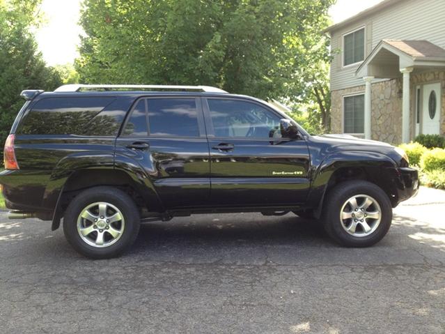

So I started this project at about 5pm last night and didn't finish until about 3pm this afternoon. I read a ton of threads about doing this install and everybody said it's fairly easy. I've got to say, it kicked my ass! Several problems that consumed time but thanks to forum members I worked through them and got it done. :party:
I used the drop the lower control arm method and it worked great. Made it very easy to move the strut in and out. I think it looks great even with the original, 8 year old tires. :eek:
Over the next couple of weeks I should have some refinished FJ rims and BFG's on it. Can't wait.
Thanks to the guys that helped me earlier today and to the wealth of info on this site.

truck looks great. I'm about to drop the daystar 2.5 up front, what were the biggest problems you ran into?
The biggest problems I had was not taking enough stuff apart to get the strut out and a seized alignment cam bolt. Here are the steps to take to get the front strut out easily:

Look's good! Doing the same thing next weekend. Have a set of 255 bfg's that is going on after. Thanks for all the info on this. Did you install this your self or did you have an extra 2 hands?
Thanks all for the compliments!
All by myself with the exception of my wife standing on the rear rotor so I could get the springs back in.

Thanks for that information. My FJ coils came this last week. I'm waiting for my 5100's and DS spacers to arrive so I can install everything. Hopefully my install will go fairly smooth. Your results look great.
Did you notice an improvement in handling? Aside from lift, I hope to get good results that others have experienced.

OHP your 4runner looks Great! I'm not saying it is your fault, but after seeing how it turned out I might go back to the spacer lift instead of suspension lift. Alimony checks have shattered my dreams of an ICON lift.
Thanks for the hints with the installation. Where did you get the Daystar kit from? If I decide on the spacer lift I'll order mine from Wheeler's Offroad in Oregon.
