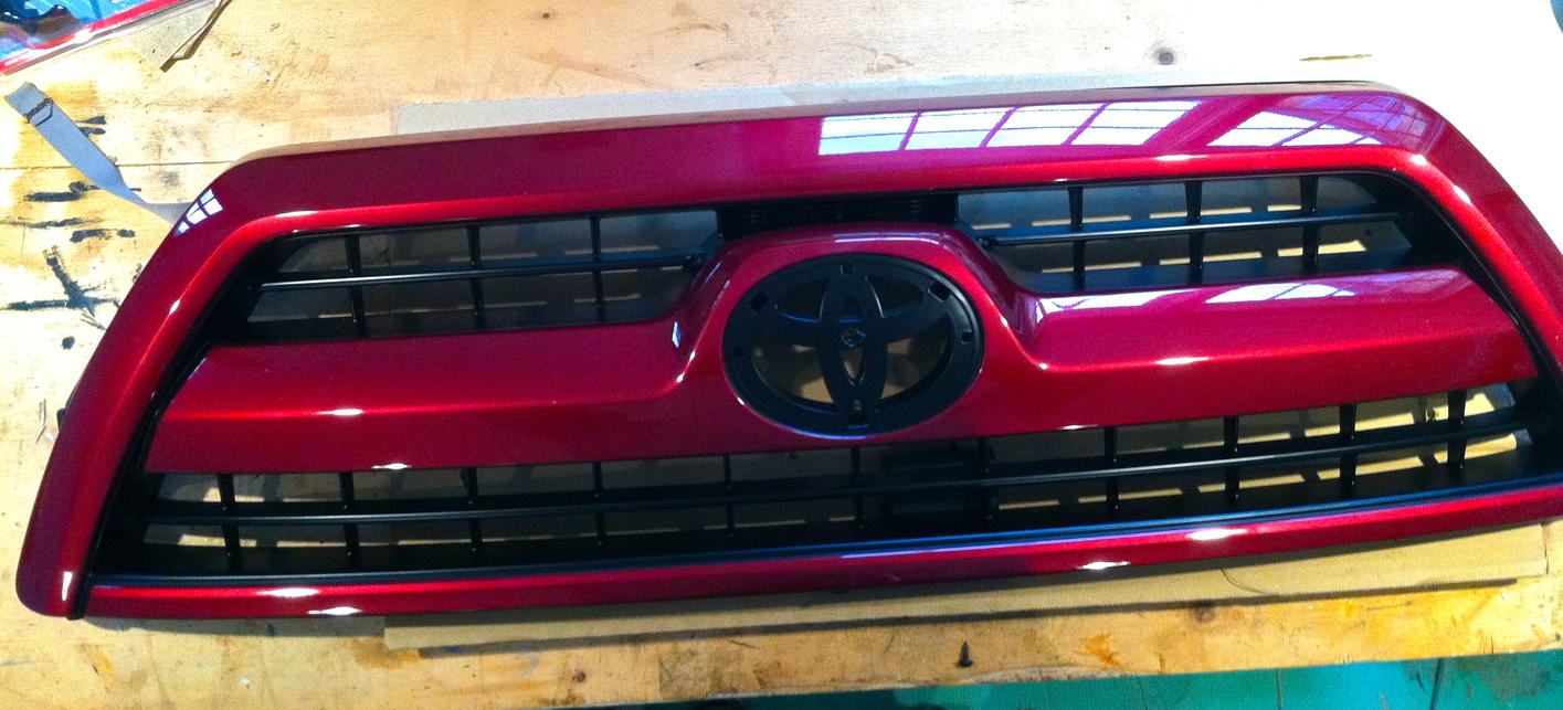

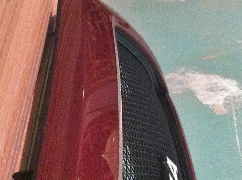

I know this is nothing new but I thought it came out pretty good so I'm showin' it off...
A color-matched grill:

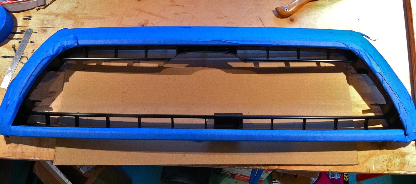

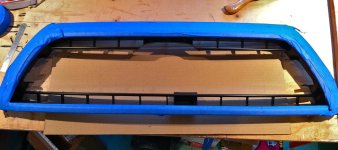

Everything removed:

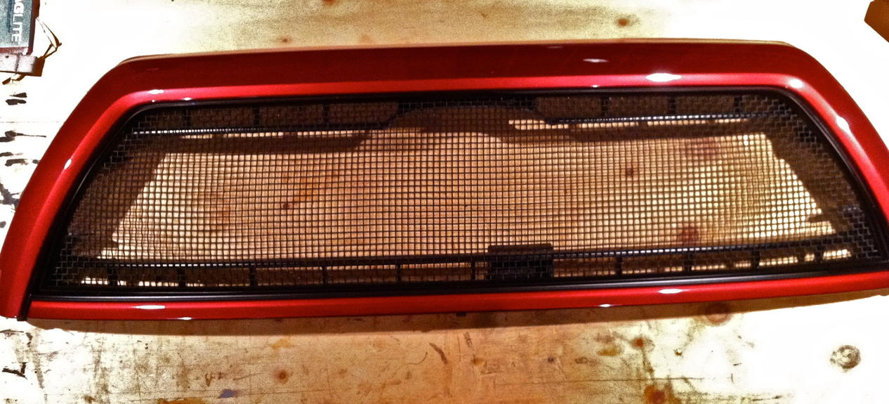

Mesh installed:

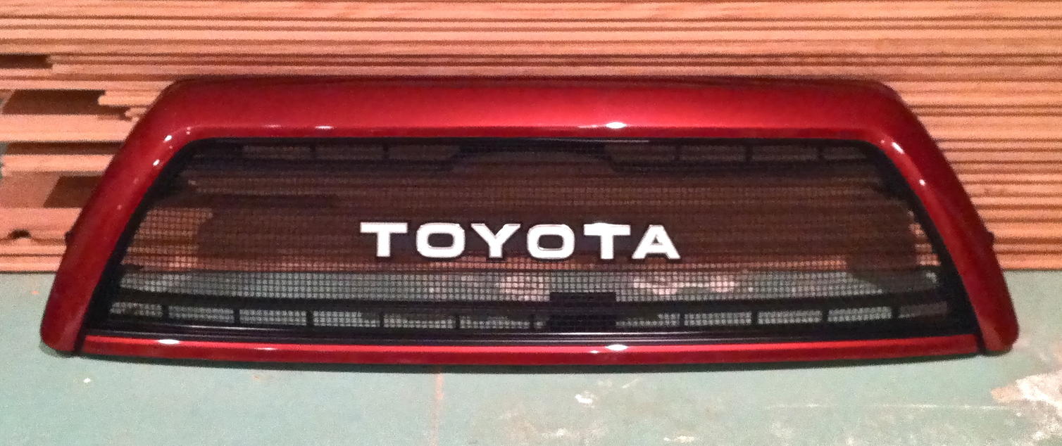

Finished product awaiting install:
Another angle:
I used stainless mesh due to the road salt up here in NH. I used black door edge guard to frame the mesh inside the grille. Kept the hood release mechanism intact.
I'll post before and after install once I get to that.

need to trim more of the grille peices off, so it will looks better witout the exposed parts, but nice work on it though. just take a dremel and cut and sand , more time put in means a better looking product in the end.
I actually left the structural parts you see intentionally. They are the structure that the mesh is held against and provide the curved face which I think looks better and makes the grill stronger. The mesh is not a flat piece; it curves top to bottom and across the face to conform with the lines of the grille.
I added two vertical bars inside that give vertical structural support and rigidity; it is actually stiffer than the original and gives a nice solid "thunk" when the hood is closed.

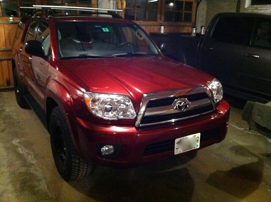

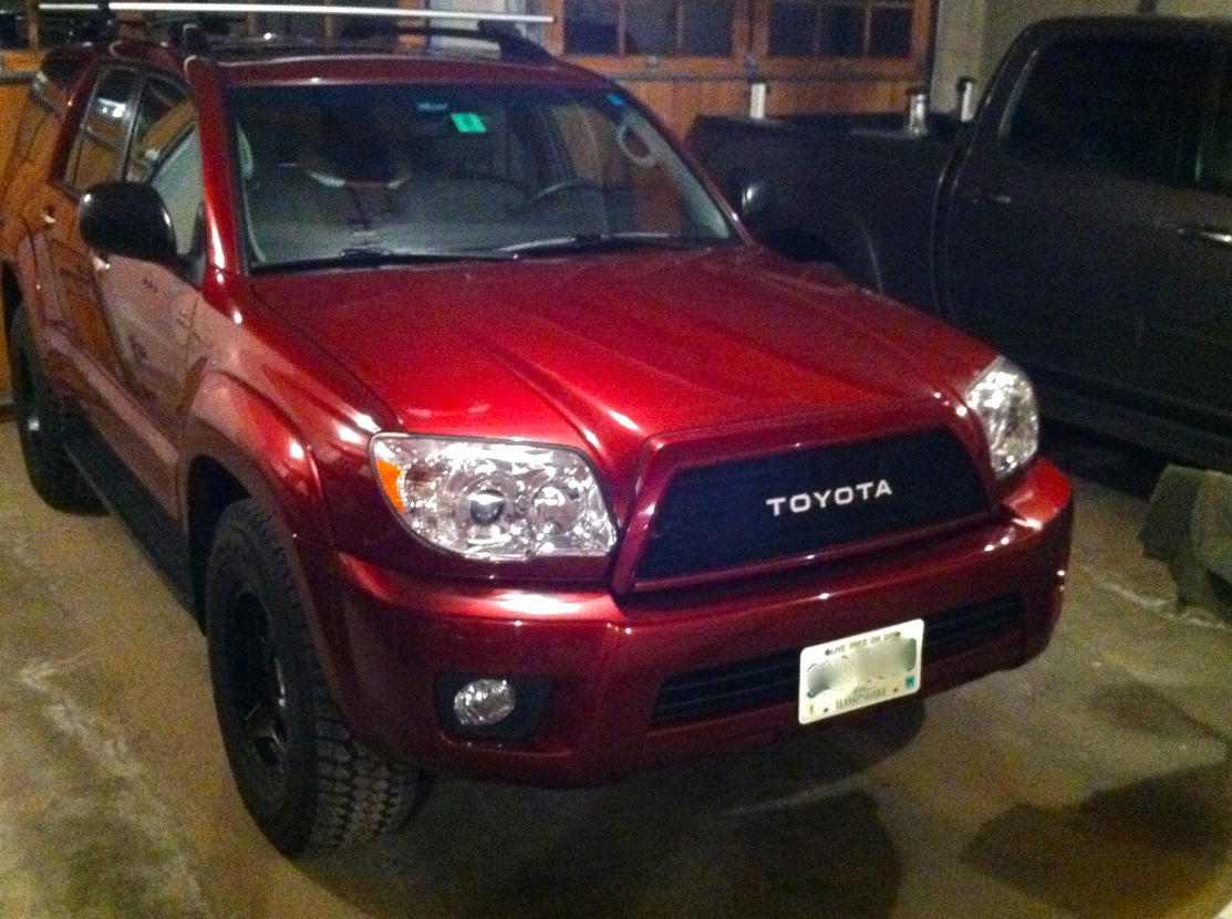

Here are the before and after pics:
So that was fun, now on to suspension...

Nice work dude, I think it's rad as it is (with the "toyota" in it), Just my opinion. Another great option for those of us that might want to mod their grill in the future, including me. :cheers:
Thanks all; the "TOYOTA" is easy enough to take off and put back (three stainless screws) so I will live with each for a while to see which I prefer.
I'm paying respects to the FJ40 which I am hoping to restore at some point.
Jon
I would leave it on there. I would love to do this to mine, but the '03 has the weak area at the bottom of the grill.

Its a little spendy since you have to buy 10 sq ft minimum but if 2 ~ 3 folks got together you could divide the ~ 82.00 accordingly. I can tell you that the mesh is very rugged and since its stainless, it should hold up well. You will need quality snips to cut it because its pretty hard and you will be snipping a little off here and there to get final fit.
I know others have used expanded galvy steel with good results also and at a much lower price. I know I will have no end of uses for the extra stainless mesh.
Something i did a little different is that i used a door edge guard that was designed for surface mount as opposed to a "U" shaped channel that fits over the door edge. I used the door guard to act as a retainer to hold the mesh in place and hide the cut ends. (see the last photo above in the original post) The structural elements of the grille that I left in place act as a shaped framework to push the mesh against. The edge guard has a very strong 3M adhesive strip that holds it in place really well.

The "TOYOTA" emblem is widely available on line but one location is: FJ40 OEM Grill / Radiator Emblem - JTOutfitters Look around as I found one quite a bit cheaper on ebay. I had to paint the yellow paint in the Toyota letters with a white white enamel paint to make it stand out but I left the chrome that surrounds each letter.

I think it would have looked better if you just kept the red center piece instead of going the satoshi route. Satoshi grills look great on black/white 4runner's though. Or it could just be me.
Nice work, I think it looks way better now!! I've been wanting to go with the satoshi grill for a while myself.
really nice work. I have a question though. I can see the two gap on the side of the grille from cutting off the center grille bar and you didnt seem to bondo that to fill the gap. does leaving it like that affect the strength of the grille?
