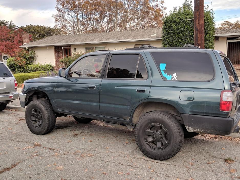

In this picture, which isn't great, you can see I have plenty of room around the tire, but is it enough room for the 33's? With the 31's looking kind of small, what is the biggest tire I can get with the ~2" suspension lift and no body lift or wheel spacers? Is there a size between the 31's and 33's that would work? Thanks in advance for your suggestions and/or advice!

The famous 265-75-16 tire, which is roughly equivalent in diameter to a [non-existent] 32x10.5x15, is the go-to, no problem, slightly larger tire for these trucks, but you've got 15" wheels. Your truck is 4WD, right?

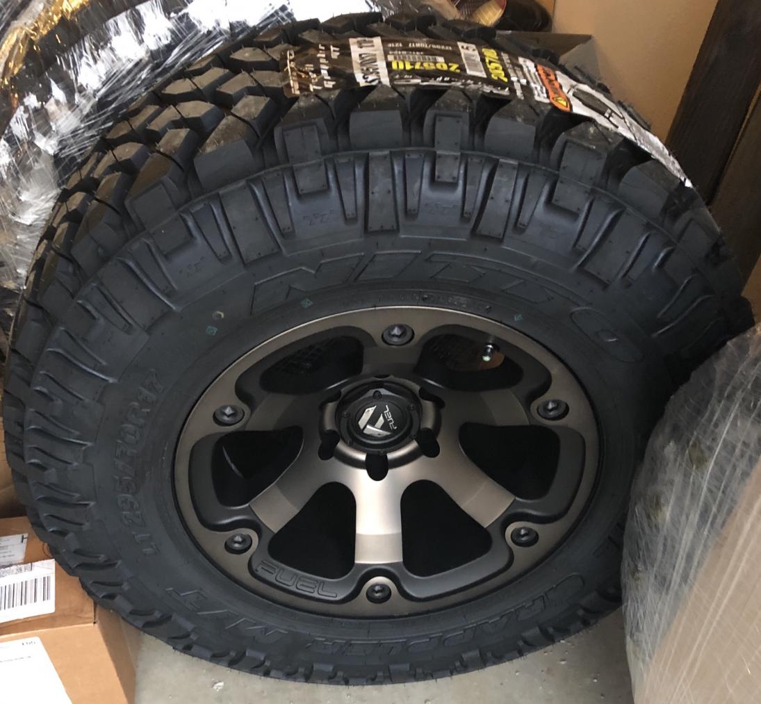

I just installed 295/70/17 with a -18 off set, with minor trimming they only rub at 90%. I could do some more in depth trimming and it wouldn’t at all. Mine is a limited so the trimming I did was on the fender flare and front bumper. The tires are Nitto trail grapplers which run sorta big, they are pretty much 34x12 if I remember correctly.
Those look real nice!
Keep in mind that a front lift won't get you any more clearance for wheels/tires. The suspension still travels in the same arc as before the lift. A correct wheel alignment (maximum caster) will net the most clearance.
265/75-16 and 265/70-17 are the max size for no rub guaranteed (assuming correct alignment). That is a small "32" inch tire. Anything larger and you will likely have to do some cutting/pounding/etc. to fit.
Wheel spacers will help with upper control arm clearance, but will make fender rub worse in most situations.

Excellent, thanks for all of the replies! So I think I'm ruling out the 33X10.50R15 for fear of rubbing. I know that the 31X10.50R15 will fit without rubbing, as that is what I have on her now, but I wanted to go slightly bigger. I do like the 265/75R16, as they are a little taller (0.6") than the 31X10.50R15, but that means I need new wheels, which is a whole new expense. So, I'm leaning towards the 31X10.50R15's.
I bought this car for my 17 year old daughter, so I'm trying not to make it too much of a "wheeler" which is why I went with such a little lift. That is also why I am avoiding dumping more money into it than I need to. However, working on this truck has made me a 3rd Gen 4Runner lover, so I can't help but to do some little tweaks to make it both better and safer.
