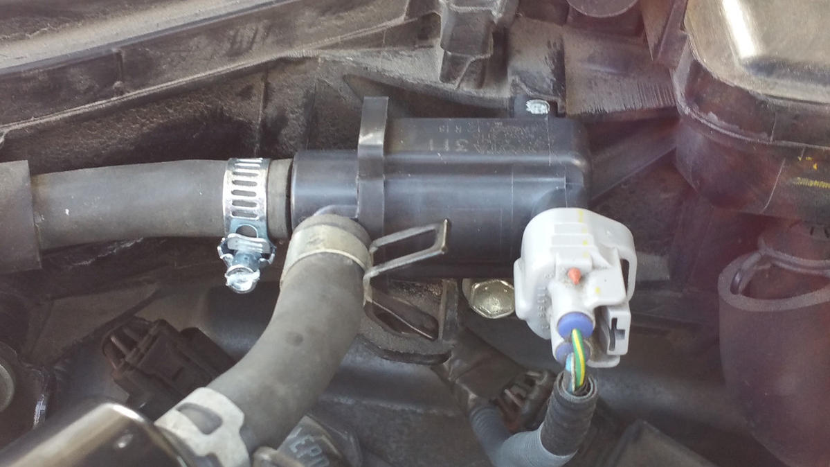

I hope this proves helpful. My original codes were: P0441, P055, P056. (Before and after gas cap replacement.) But after squeezing the engine- side VSV tubing into it's fittings a week ago, my scanner showed ONLY P0456 ("small evap leak"). So maybe it's entirely an issue with the hose. Toyota did not put claps at either end of the engine-side hose into the VSV on the Gen4 V6 engines. This the VSV which is bolted on the engine, driver's side high up. (There's another VSV integrated into the evap canister above the spare tire. That canister and it's hose connections can generate the same codes, so see also: http://www.toyota-4runner.org/4th-gen-t4rs/223147-code-p0456-when-its-not-gas-cap.html#post2424453).
Yesterday, I put in a new VSV, and I added clamps around the engine-side hose terminations. It's quite possible that I only needed the clamps - but I did the VSV as well. (Photo shows VSV and one clamp, after install.) After driving two 10-mile stop-and-go trips yesterday (0-50 MPH, a few stop lights), I left it overnight for the computers to execute the tests - and re-blow the failure code, if it was inclined to do that.
But today, it started clean. And after a couple of short trips, I have not seen CEL, or the associated dashboard errors lights. So: Maybe the second "repair attempt" after you see codes P0451 / P0455 / P0456, after a new gas cap, should be: put on the hose clamps which Toyota neglected to put on that dang hose. :second:

I mean it's possible, P0441, P0456, and P0455 are not limited to the Gas Cap; that's just a very likely candidate.
I also wouldn't entirely fault Toyota for that, you'd be surprised how a lot of those hoses tend to glue themselves onto their fittings naturally unless they're high-pressure so a clamp may not have been as important on that side of the VSV.
That being said, adding a clamp because 11yr old rubber hose is maybe not gripping as tightly as it should? Not gonna hurt anything. :)
