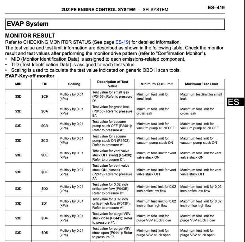

Not sure what engine you have but the 2UZ manual section describing in detail the evap system is ES-419 to ES-453. There is a lot of really good trouble shooting info and system component checks in there. Here is a shot of the first page.
