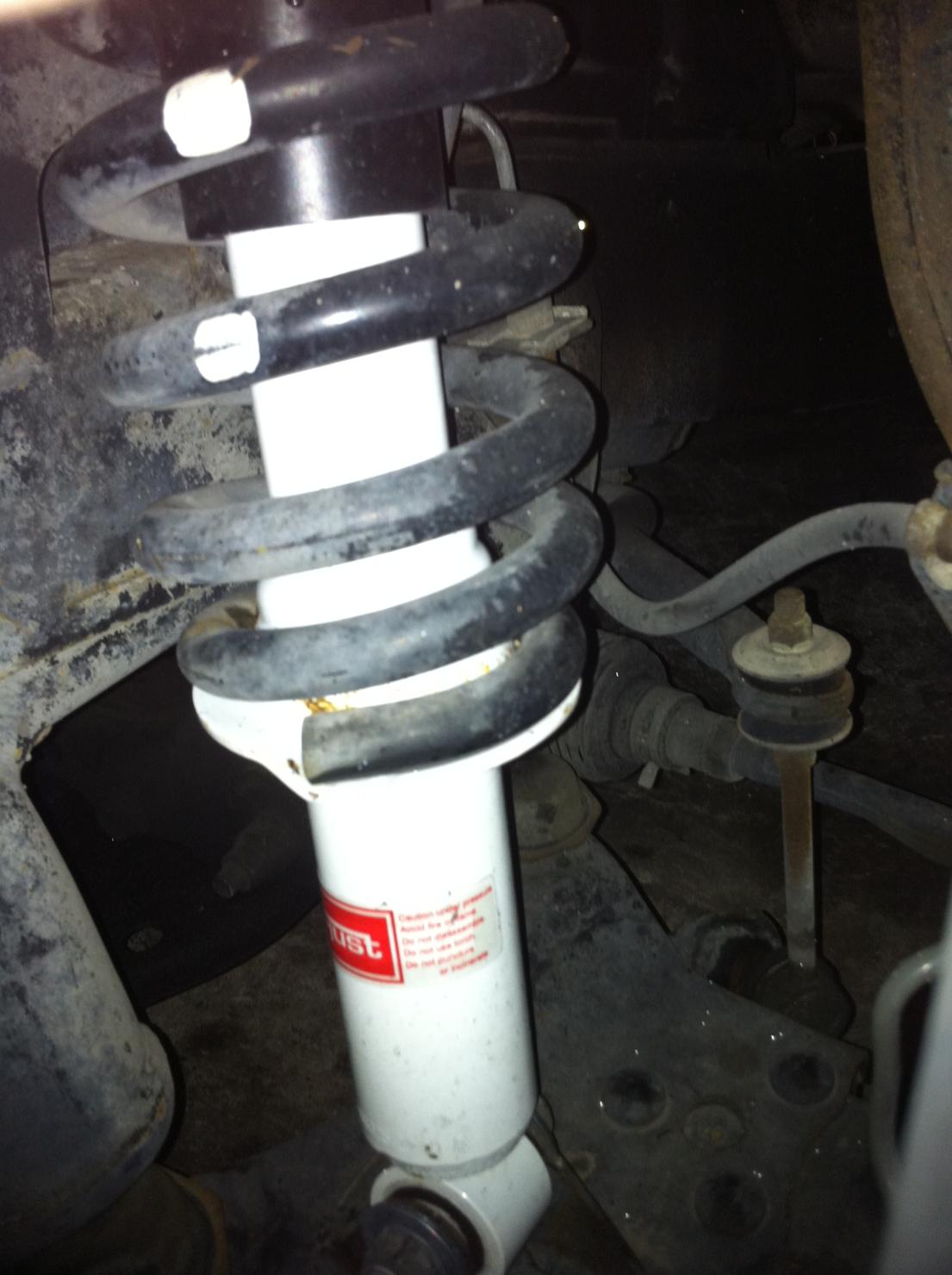

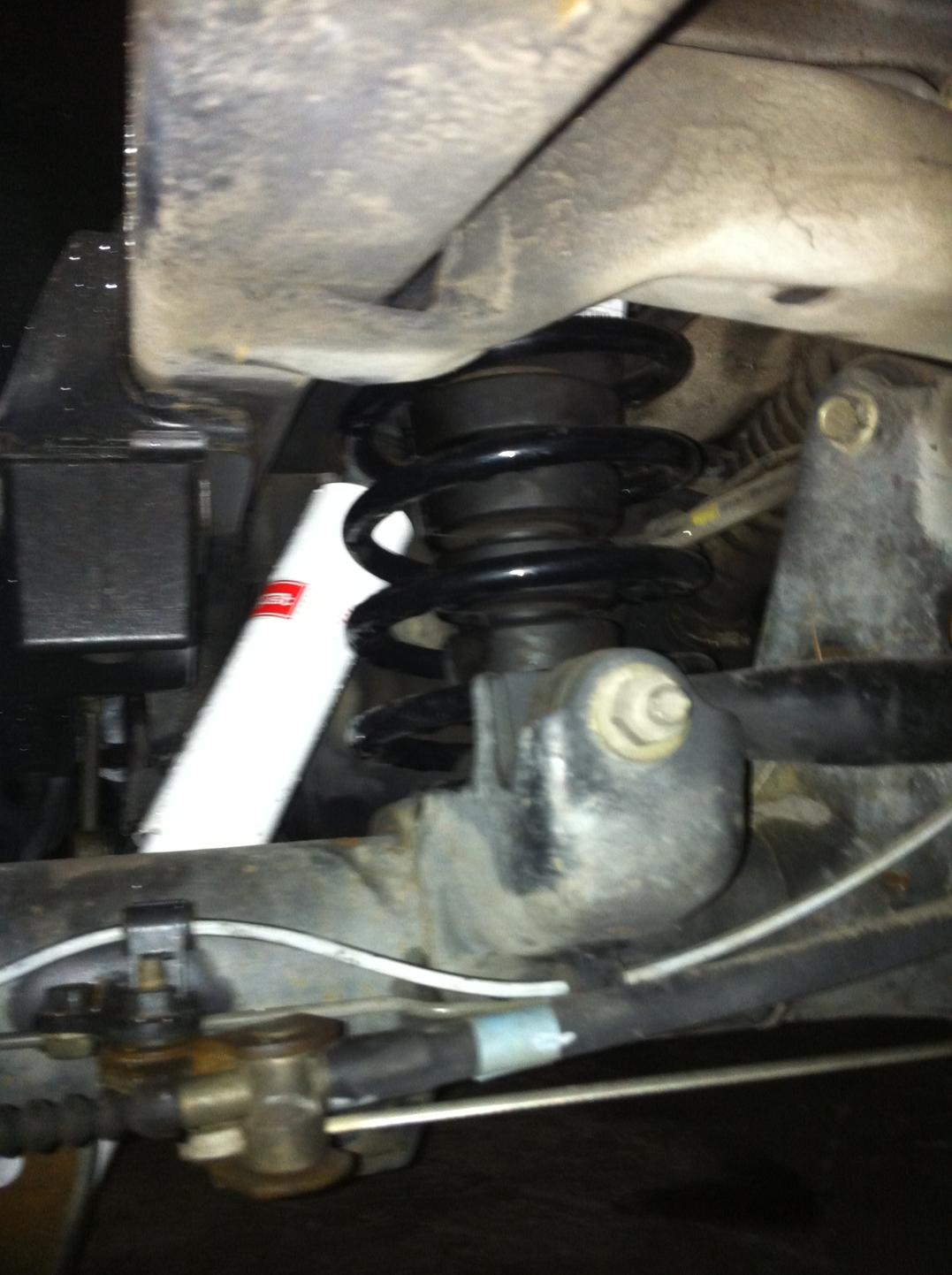

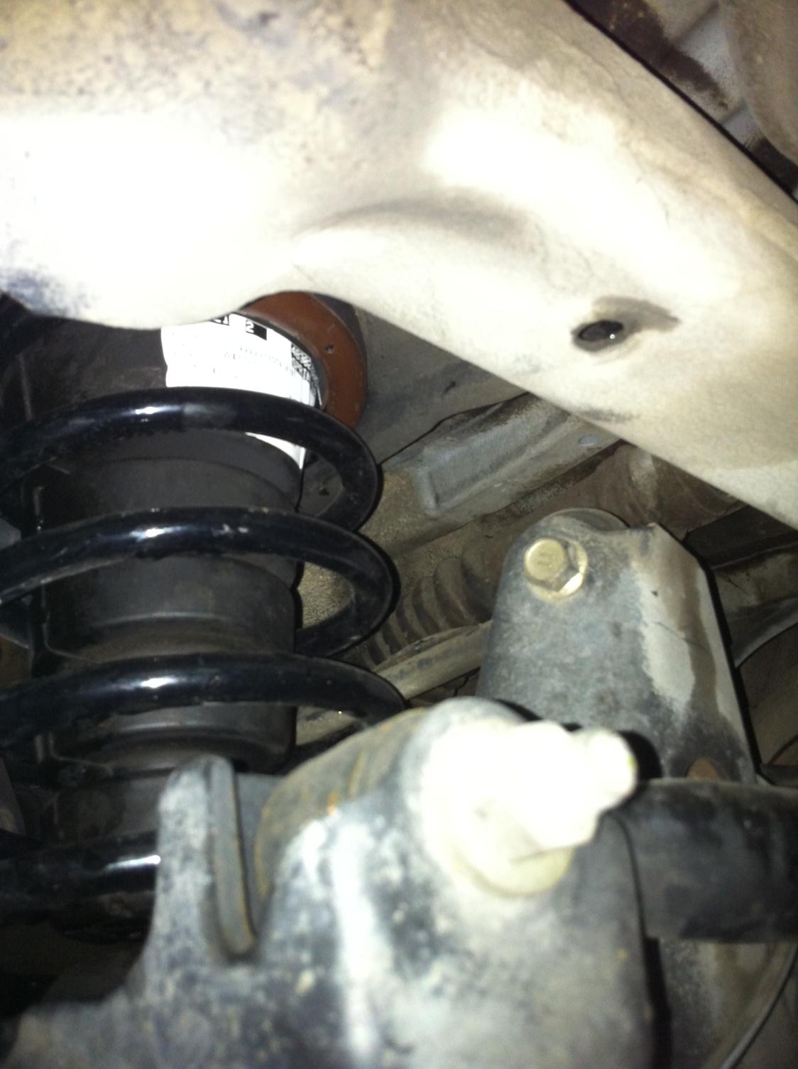

Hi my friends, i have my 98 SR5 recall for the rear suspension about 3 months ago, the truck rides better but when i have some load in the back it feels like crap, i cant have 2 people on the back. I just install NEW KYB's all around, I don't whant to lift just a better & stiffer rear springs. Any ideas???

I have NOTHING on the back of my 4Runner, the springs where rplaced by the dealer 3 months ago, I went back & they told me that is an old truck and there is nothing that they can do for me ( I have 3 Toyotas in my house), that they don't have parts in stock for my 4R anymore. The truck is level back & front, just when i have a small load on the back I have the problem:wtf: By the way, where can i buy 99 OEM rear springs, i whent to my local junkyards and nothing....

I have agree with those that say you have way too big of bump stops in there, that or the dealer put springs in there from a Buick.
