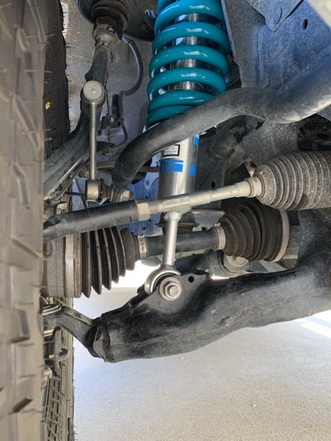

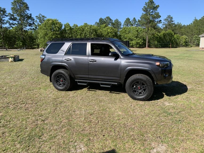

I just installed my front 5100’s and Dobinson 1.75” spring yesterday. Going to do the rear 5100’s and Dobinson 1” Today. It’s my wife’s ride so it won’t see much off roading if any at all. Just a pavement princess type thing, but I didn’t feel that much more stiffness on the drive home besides the decrease nose dive. Paid in the $700’s (can’t remember the exact cost) for the setup.
