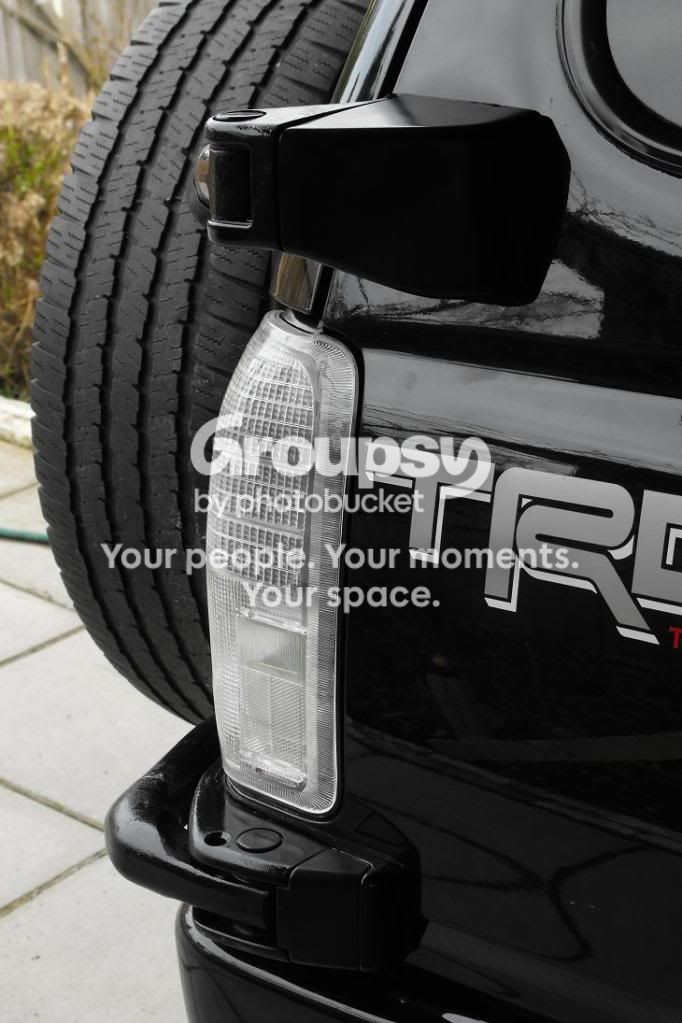

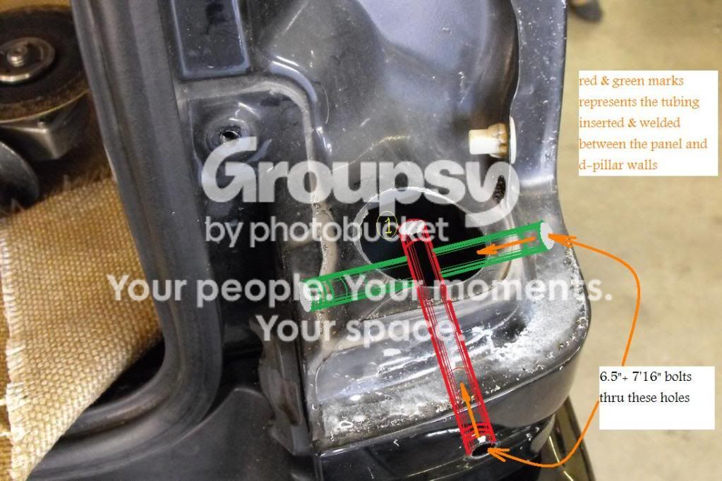

My Surf/4Runner is only imitation and is no different than any other 4Runner. And maybe I didn't explain it clearly and hopefully this picture can better let you understand.

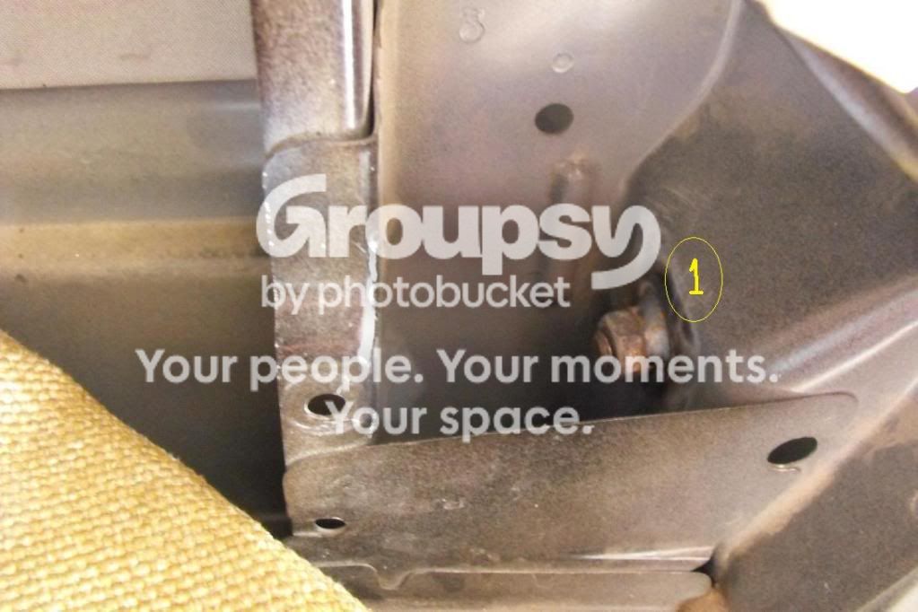

This picture shows the taillight removed, a 2" diameter hole drilled on the base to gain access for inserting the 2 rigid wall tubings that were later welded to tie in the body panel to the d-pillar walls. #1 encircled in yellow shows the end of the tubing at the d-pillar end...See 2nd photo for reference

and no didnt know you did that. so you put metal tubes to re-enforce? and ran the long bolts through those tubes? what did you do to the top? and how did you seal that hole back, or did you even? and what about water and rust in the bolt holes?

Yes steel tubings were welded in place to tie in the body panel and d-pillar together to form one solid unit both upper and lower mounts, and yes bolts thru these tubings also. I applied some rust inhibitor for the drilled holes and as far as sealing them, you can use some silicone around the hinges once mounted to seal from any water penetration.
Check my build thread for more reference.
Yes and in the exact same fashion as the lower hinge except ofcourse much shorter tubings were used. Again all explained in my build.

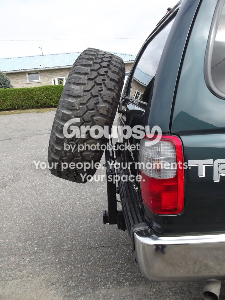

Here's of the original Hilux Surf

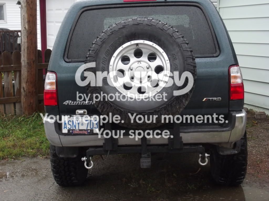

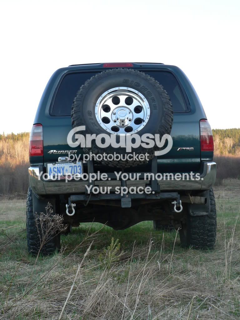

And mine
13-3.jpg~original

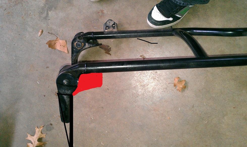

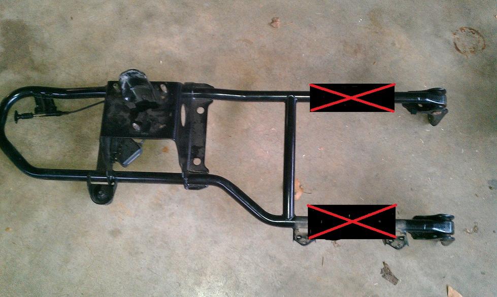

ok so did some talking with my fab guy. its going on the body 100%. and here are a few pics, will most likely work on it thursday. talking with him he like the little pipe idea and so do i, but i would beef it up more, and talking about cutting about a foot out of it kinda where the license plate mounts to have less stress and to see out the back more beings there will be a 35" spare, and talking while its cut up drop it down so instead of like the silver one where he brought the latch bracket up, it would be centered in the existing plate mount on the hatch the tire would physically be lower, if you get that. and the top hinge mount has to be extended because it only has 2 holes and one is right in the gap where the body and hatch meets.

Cool beans! Glad you have a fab guy helping you out with this! Can't wait to see how it looks!
P.S. Not sure how much wheeling you wanna do....but having the tire sit lower will kill your departure angles.....
That being said...you are running a 35" spare....and it might be more obstructive than my 33". I personally don't find mine to be too much of a pain....as it actually helps block people's headlights from my rear view!

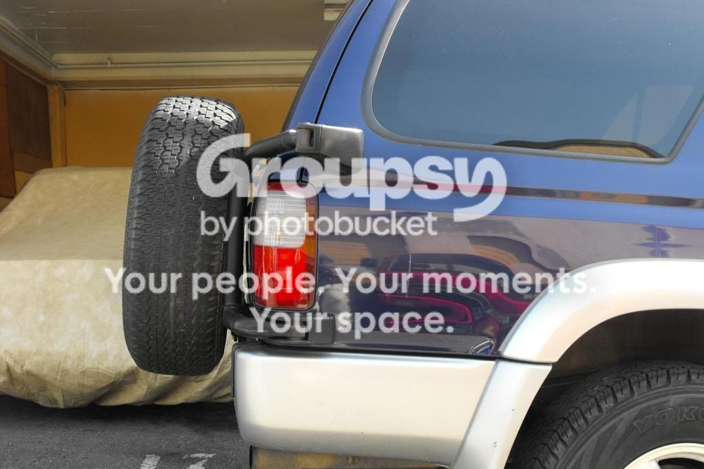

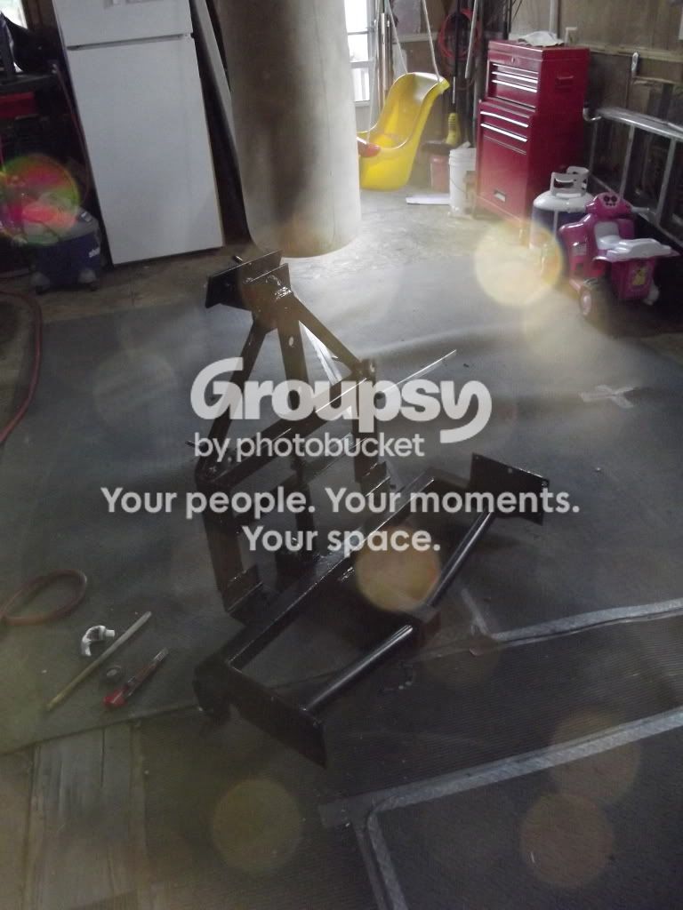

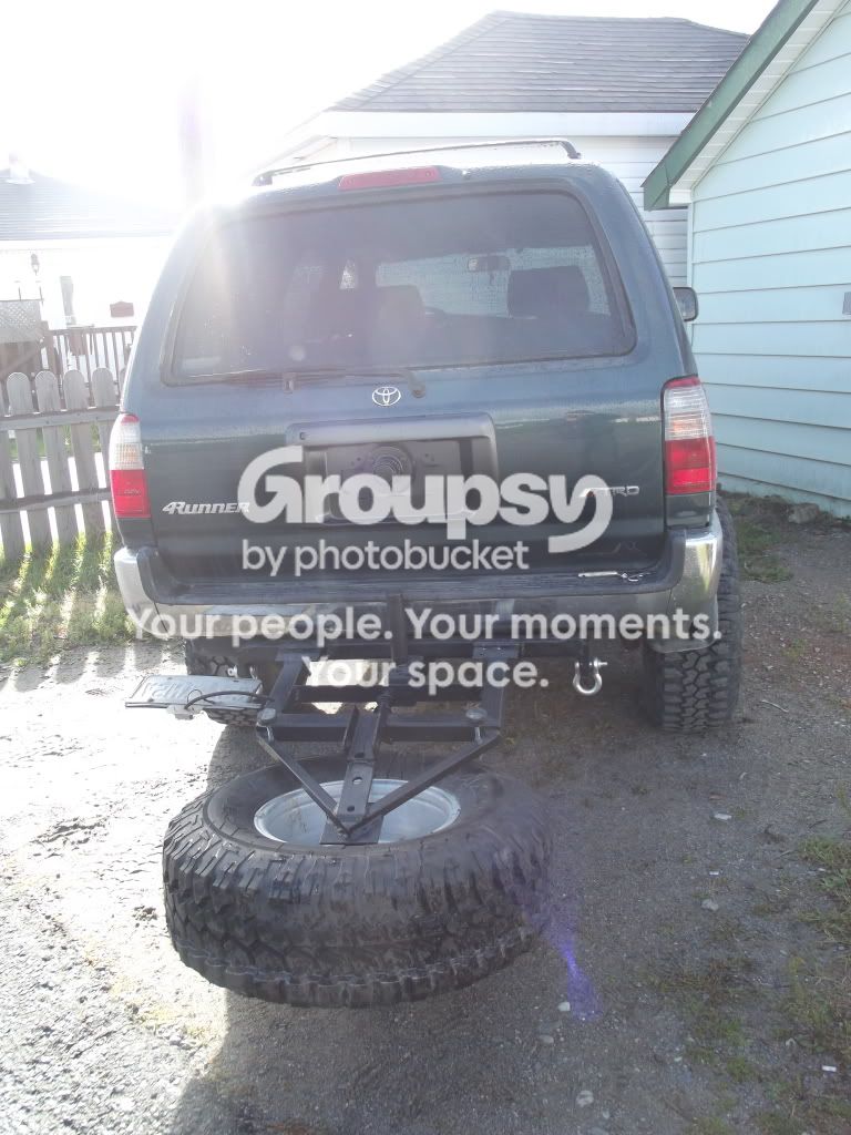

Here are some pics of my setup:
Off the truck,
DSCF5316.jpg~original
Some shots on the truck:
DSCF5598.jpg~original
DSCF5597.jpg~original
DSCF5528.jpg~original
DSCF5319.jpg~original
And a parting shot:
P1120725.jpg~original
You may be better off doing what you're planning on doing....just shooting some ideas around for you.....
