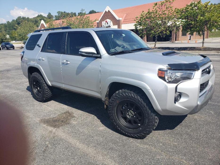

Okay, so I gave up on the KO2's and had them install stock size Yokohama MTG003's. Issue gone, wife happy and truck looks just as good, especially with the new Method 316's. DT treated me very well through the entire process. I got fully reimbursed for all 5 tires and actually got money back as the Yoko's were cheaper.
