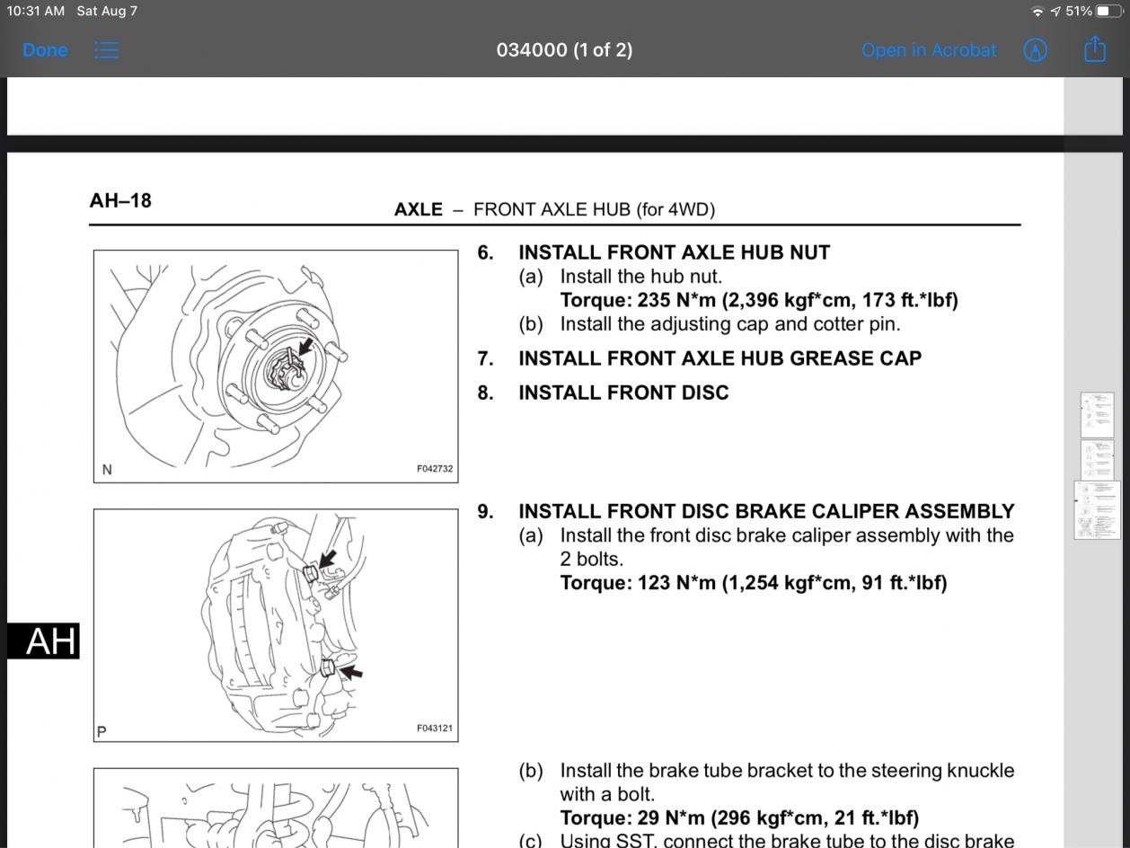

Torquing the axle nut too tight or too loose is the biggest reason for failure. Dont just bang it on with an impact wrench.
