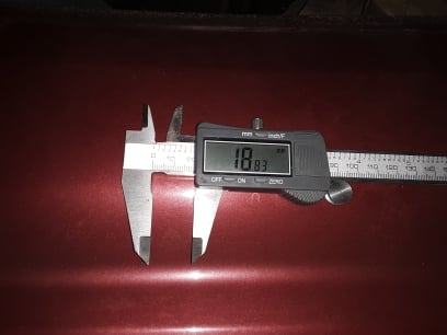

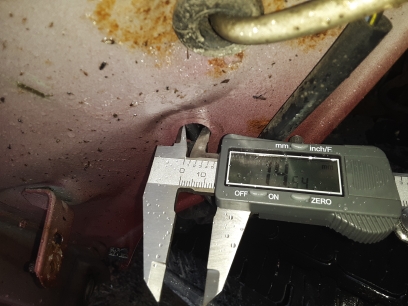

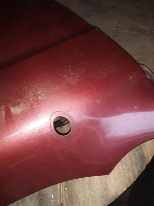

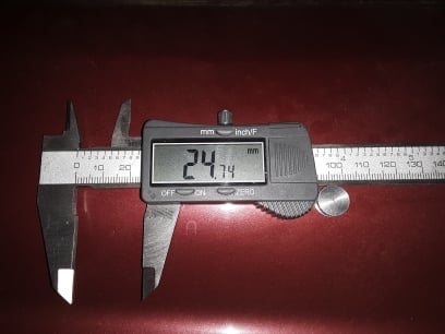

The fender hole is oblong so you need 2 dimension.
The fender in the firewall is small.
Long story short fender hole max 18mm
Firewall hole 14mm

If you want a bigger hole in that firewall you could do that as its only 14mm. However, your fender is going to have to come off to drill it.
I figured you figured out the body hole was 14mm and the fender was oblong the larger measurement is top to bottom with the other measurement side to side
So there you go that's off a limited 1998 3rd gen 4 runner. :)
