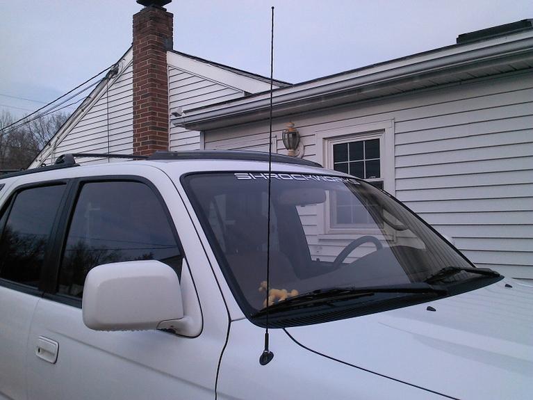

Thanks for the heads up guys. Definitely going to go with the Taco whip mod. Anyone know if the part number listed for the black taco is for the long black taco antenna or one of the newer, shorter looking ones? Kind of like the old school bendy look.
Whip Part Number?
Hey, did you get that done after all? It seems the part number shown for the whip 86309-AA0400 has changed, and the only one I can find is for a "pull-top" model. If you found the long whip style, what was the new part number?
