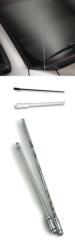

you could always get the steel one from performance products. i think it was a "billet" stainless stubby antenna. just a thought.
I don't know why I didn't think about Performance Products ... I guess that's the purpose of this forum. Thanks for reminding me.
no problem. i just looked at the book on the floor this morning. i will thumb through it tonight and try to find the exact part i was thinking of, and get back to you with a price if you need it.
I looked them up and they're about $18-24. They have a few different sizes & colors.
Link to web page.
It's certainly better than the standard antenna. Ideally, if I could find something sturdy enough to withstand a contact-carwash that would be best. At roughly $20, I'm not opposed to trying this one out but I'll do a little more searching to see if I can find a shorter thick rubber type.
