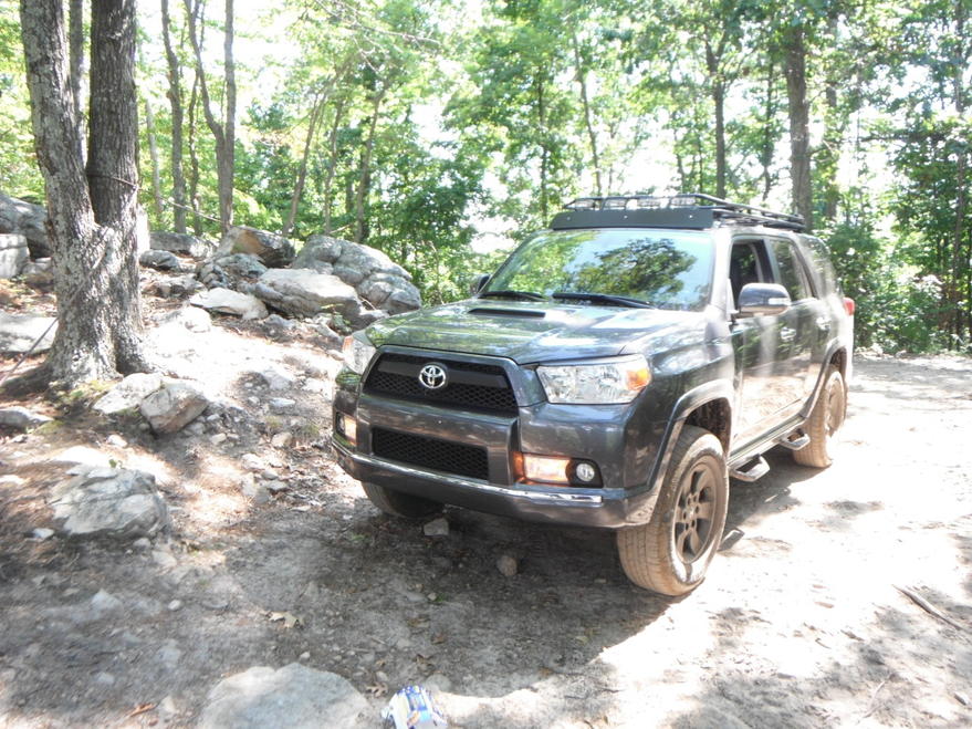

I had a little free time in the garage today, and planned on wrapping some chrome strips with the left over 3M matt black vinyl from Kraeken's hood.
Go figure- the scraps we had left were just a bit short, and I wasn't about to splice it. I started to look for other things to wrap and decided to do the headlights. I did this a long time ago with some plastidip but it never looked quite right, and wasn't durable enough for this area.
I know somewhere on this forum I saw someone else had plastidipped their lights too- can't find the thread though...Anyway-
Basically, I took some paper and taped it on top of the light bezel and traced around the edge with the side of a crayon to get the rough shape. After a few adjustments, I had a template that I could tape to the vinyl and cut out with a pair of scissors. Only need one template- just flip it over to do the other side.
To install the film, remove the backing and carefully line up the front edge. Make sure it's smooth all the way around (fingers and a felt squeegee work great). Then carefully trim some of the excess from the back side (the top of the bezel). Heat small sections with a heat gun (careful, just a little bit!) and squeegee towards the back. With practice and patience it will work out perfectly.
It toook me 3 botched attempts to get it right.
After the film is adhered to the top of the lense, make sure the corners are crisp, trim around the light housing and wrap it around the edges. Pull the rubber weatherstripping back and tuck it in there. Done!
If anyone wants to do this, PM me your address and I'll mail you an Antman Eyebrow Template.:thumb3:
Here are some epic photo's...
Before:
DSCF1441.jpg~original
DSCF1440.jpg~original
After:
DSCF1445.jpg~original
DSCF1446.jpg~original
More pics:
DSCF1439.jpg~original
DSCF1437.jpg~original
Outside in the sun:
DSCF1447.jpg~original
DSCF1449.jpg~original
DSCF1451.jpg~original
DSCF1450.jpg~original
DSCF1448.jpg~original
This is what it looks like...dirty! :lmao:
The film also blocks the sun from shining into the lense and the lights have a darker look in bright sunlight.
Subtle, but noticeable, and it should last!
I'm pretty happy with it- what do you guys think?:confused:
