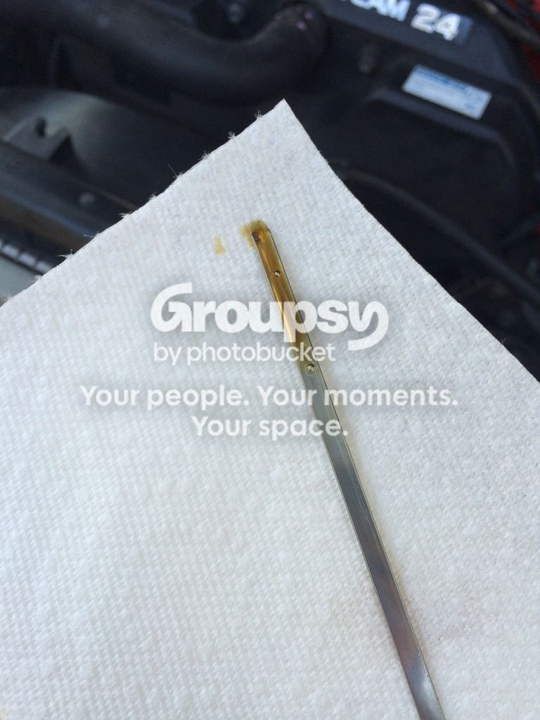

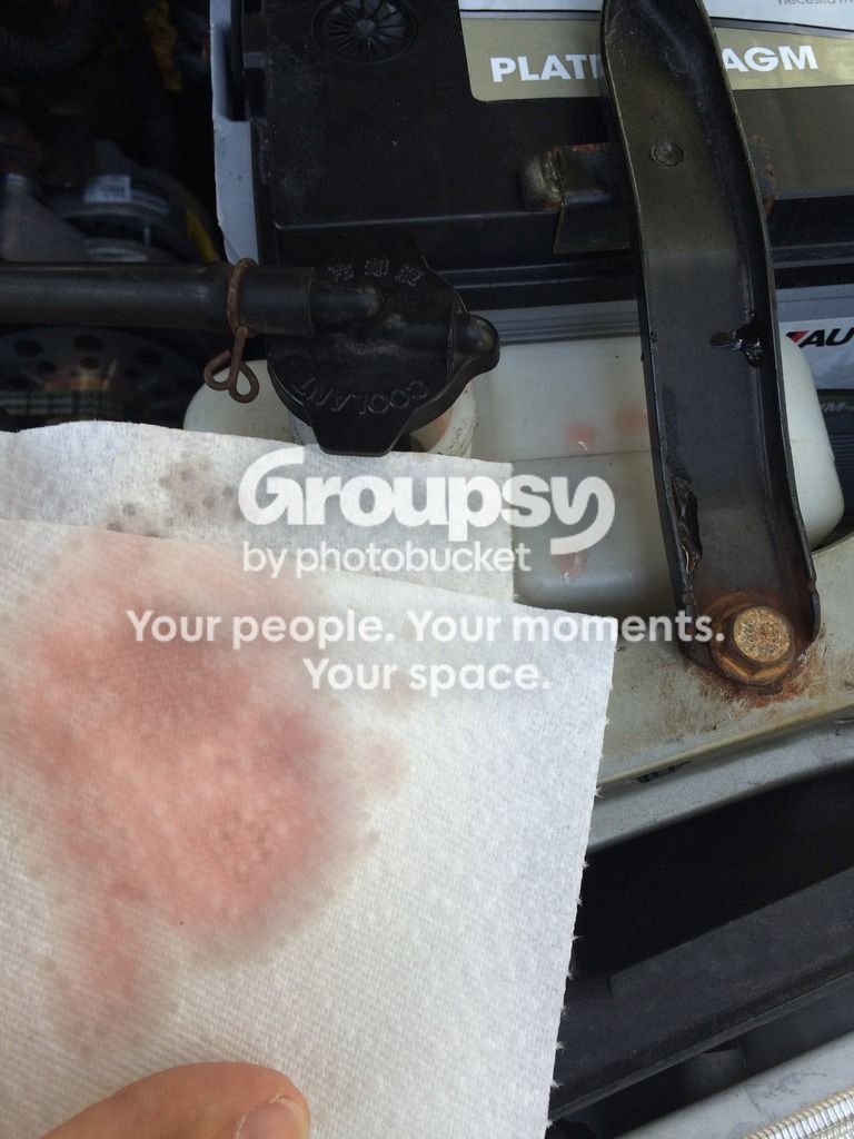

thanks for the thoughts folks. I checked the oil and coolant, both are good as you can see. Oil was changed on 2/7, or 1,604 miles ago. The picture of the coolant doesn't do it justice....in reality it's crystal clear and looks almost just as red as 100% OEM red.
I guess it's off to the stealership for a new cap and then maybe to napa for the combustion gas/coolant test kit.

The oil looks fine.
