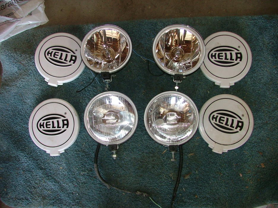

see above ^ i have 2 500 and looking to replace my other 2 bad ones. cant tell any difference really, besides price.

500ff's on top 500s on bottom
