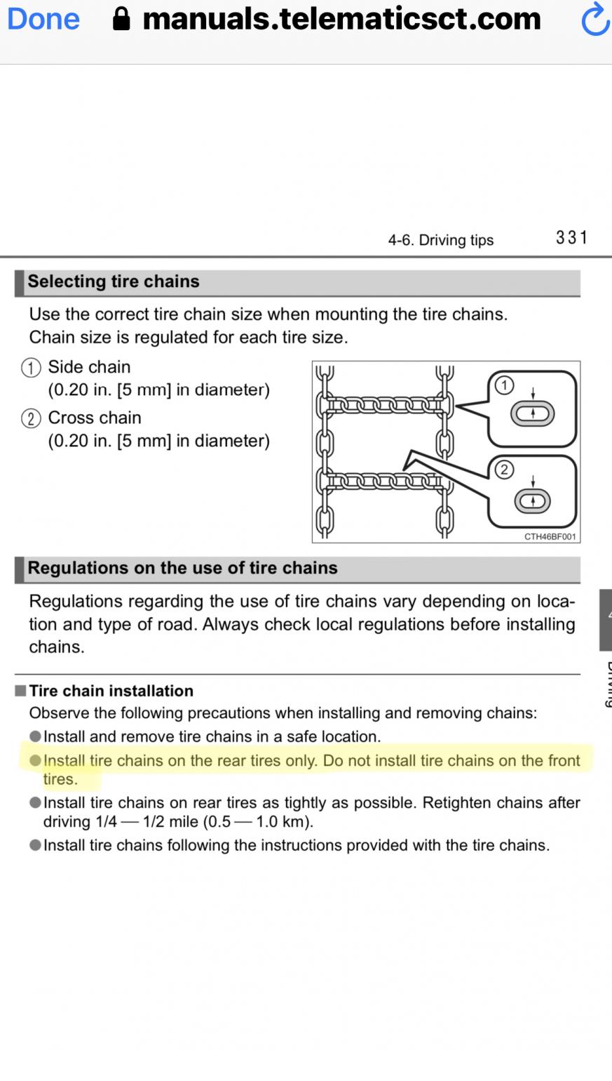

You are not considering chains for the front are you????

You should read your manual….
This:
I am guessing the reason is mostly due to clearance issues. I did see a few 2nd gen tacos out there with chains on the fronts.
Thank for bringing that up though, as I havent ever even thought about chains till now.
I don’t know how much more clearance tacos have over T4R’s, just know I’d read before and saw vids of not using chains on the front end due to clearance.
