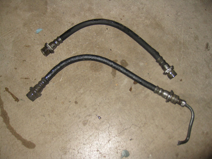

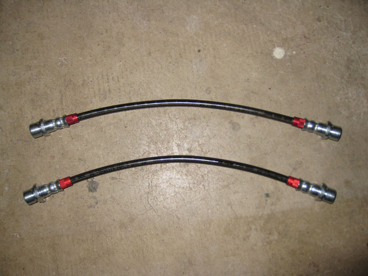

So that was an epic fail! Everything went fine on the rear, but when I got to the front right side sh*t hit the fan. I was trying to remove the brake hose the 12" of it and right off the bat I stared to round off the nut that is threaded into the steel brake line. I blasted it with PB Blaster before I totally rounded it of but to on avail. I wrenched on it with everything possible but I think the only think that might loosen it is a torch and a vice-grip. Thinking that I will go pick up a crack torch from some gas station or something tomorrow.
:roadkill:
From the ware on the existing brake hoses and how hard it seems to be to remove them I am sure these are the factory lines. I really hope I don't have to take this to a shop.:cry:
Here is what I trying to replace the OG's with. From Metro...

It looks like he was replacing them with the ones pictured above.
Oh I get it now...
Why replace them? Are they super rusty?

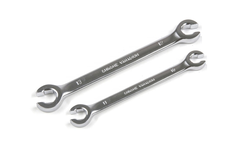

They make special wrenches for working on brake lines, more points of contact, harder to slip off and round the nuts, well worth the $10 I'm sure you'd agree at this point in the project.

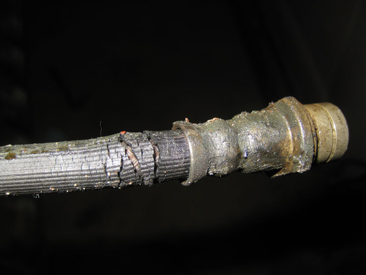

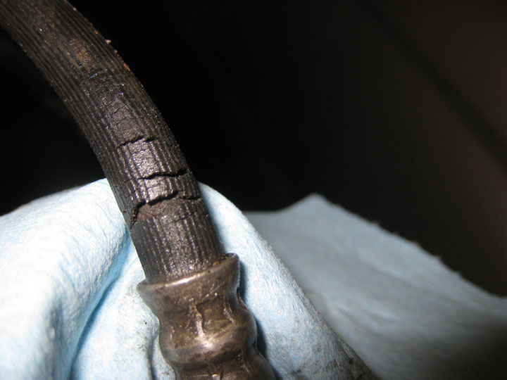

These are the culprits. And this is why you want to replace 14yr old brake hose NelsonMD.
And boy was my brake fluid dirty, looked like watered down coffee... tasted like it too!:hatsoff:
Was there suppose to be a picture there?
