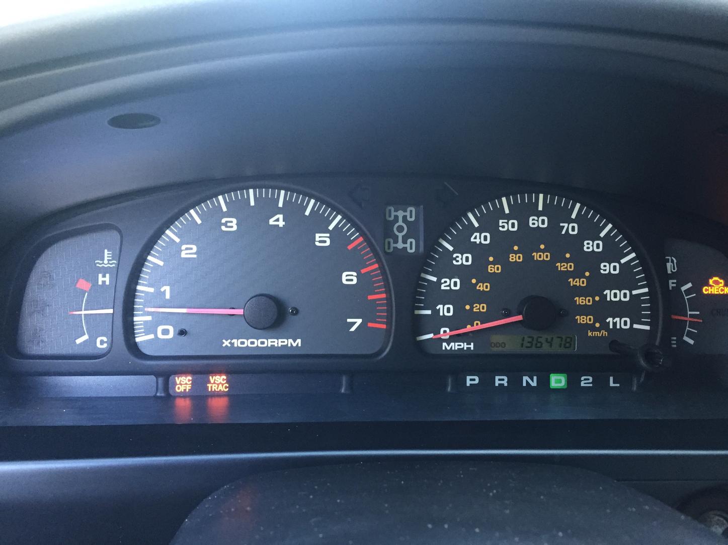

Has anyone had this before? Any recommendations or thoughts would be greatly appreciated. Got in the truck heading home from work and these popped up. Only time it's happened before, I was missing an ignition coil and had it replaced. I could feel a huge difference in Drive quality but everything seems standard at the moment.

Have you tried getting the check engine code scanned at an auto parts store?...
The common reason all of those light up together is P0420 which is usually fixed with a new O2 sensor.
I have yet to take it to the auto parts store as it just happened on the way home. I appreciate the heads up with the O2 sensor. Hope it's something simple like that and I can make a quick fix.
