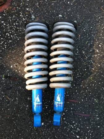

Any help with these off a 2000 Tundra?
soreng
I saw these on C List... They were used as "leveling for a 2000 Tundra. The guy had a different set that added 2+ inches more than these, so he used those. He thinks these have less than 1000 miles on them. Take offs when he got the truck. He thought that these coils and shocks added 1.5 inches from stock. These are from a non TRD Tundra and not OEM! The price is right just wanting some input if you all have any!
My First post! Thanks in advance and also thanks for the great forum! Keep it up!
For my 1998 SR5 5 speed with 190000 on it.
I can't speak to those units themselves... but can say that a set of Stock TRD 4X4 struts will lift your 4RUnner a good 2.5". If you use the units you posted, they would most likely give your around 4" of lift in the front.... and that would be too much for the front axles to handle. You'll be blowing C.V's and flinging axle grease all over the place.
Good deal... but I don't think it's a good choice for our trucks. :(
Thanks for the thoughts...just about what I was thinking as well. Always good to get confirmation!! I will keep me eyes peeled for the right stuff for the right price...
