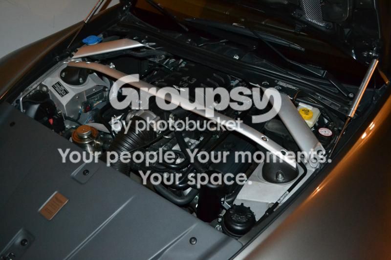

Picture below for reference, the catch can is in the bottom of the pic next to the power steering fluid reservoir. It's extra shiny because it's brand new and the rest of the engine bay hasn't been cleaned lately lol.
