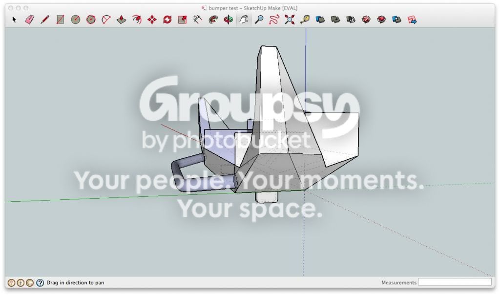

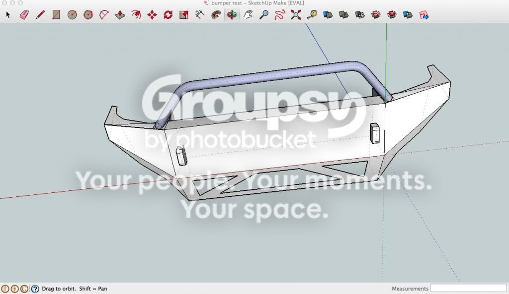

Heres what I have so far for a front bumper
Similar mounting to shrockworks, and has a winch carrier. Will also have fog light holes optional and turn signals for 03-05 4runners that dont have them in the headlights.

Looks pretty sweet overall, but why the holes on the bottom?
Seems like that's a less ideal place than on the front like most since that's a vulnerable approach area and protects the lower radiator. Also, would you be able to access the winch from underneath like that?

My thought would be airflow to the radiator. Many of the current offerings don't provide much lower airflow to the radiator. After having this issue with my LandRover I was hesitant to add an aftermarket bumper on my 4runner.

The holes are there for air flow to the radiator, but now that you mention it, it does make more sense to move them up. Ill probably move the two smaller triangles to the top, and maybe just get rid of the larger center hole altogether. That would also allow better winch access, as it could be reached from the bottom, but would be a little awkward.

I dont think the triangles down low are going to reduce the protection to the bottom of the radiator, as long as your using a substantial gauge sheet metal.
Do you have a cnc that your going to cut them out with or are you doing them with a plasma?

It would be all 3/16" plate so strength shouldnt be too much of an issue. But stronger is always better. As far as cutting, Im not 100% sure yet. I was about to pull the trigger on a plasma, but I just realized my compressor might not be able to keep up. There is a local metal shop that does laser cutting, but I think it might be too expensive to have them cut that way. Ill have to give them a call to figure it out.
