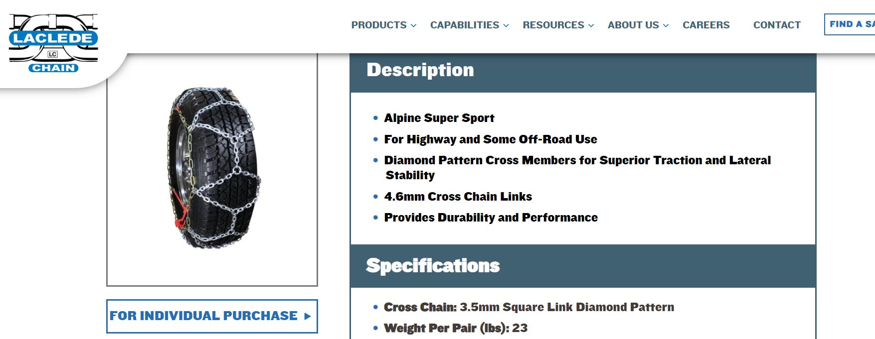

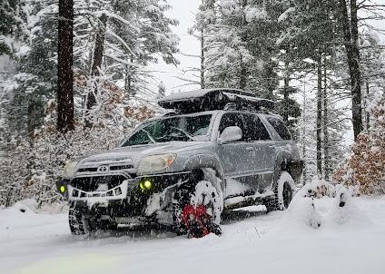

I'm curious if anyone has any luck finding a set of snow chains for their front tires. As y'all know the clearance is tight between the sidewall and the UBJ. I have SPC UCAs but even then clearance is tight with this set that I used to run in the rear, see the attached pics. You can see my red snowshoes leaning against the front tire. I tried fitting the Laclede chains shown below up front and the clearance is just too tight for comfort. It won't take much to destroy/damage the UBJ in short order.

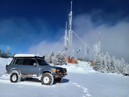

My 80 has ladder chains front and rear with quality bungee tensioners.
