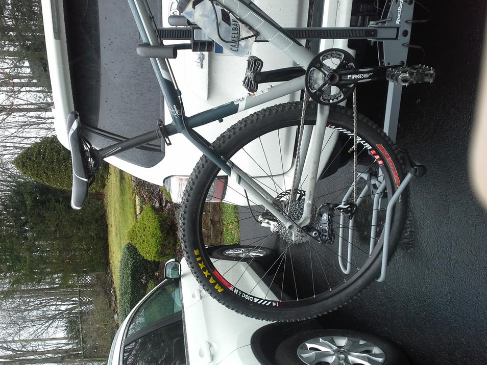

As you probably read my odyssey converting a singlespeed hard tail to a 10 speed I wanted to show off my work lol. I tried to love a full suspension and then tried to love a new bike but this bike is what I love to ride.
New:
Rear wheel and 32 spokes
Rear XT hub
X7 1X10 Cassette
X7 Medium length Rear derailleur
RaceFace front ring
New Chain
X7 1X10 Shifter
Rebuilt front Fox Shocks
New brake pads
Here it is getting ready to ride right after Christmas:
