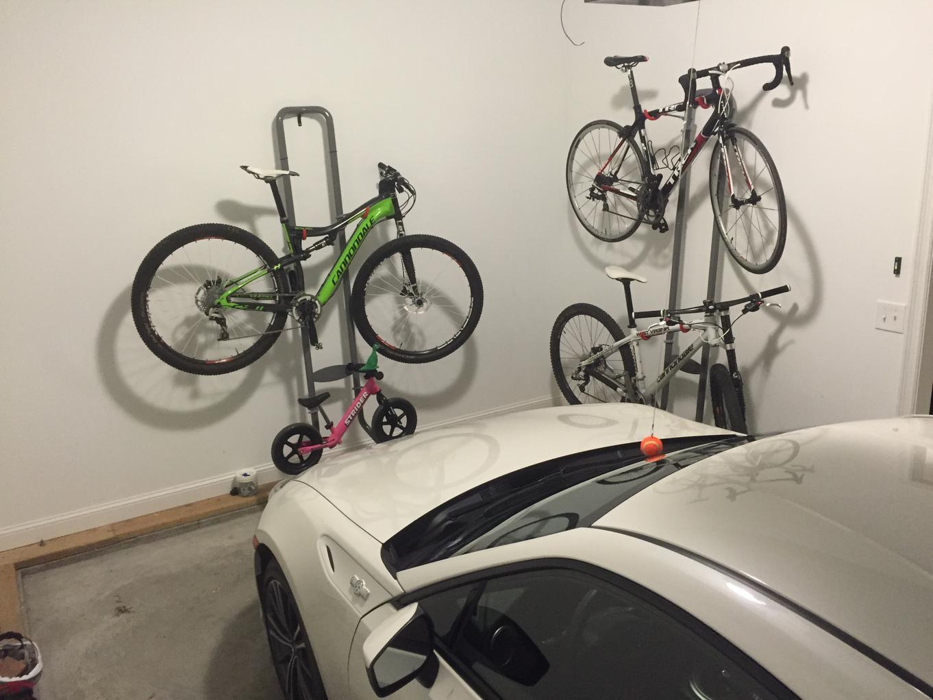

Anyway, in preparation for the Race Deck flooring that is due this week and my Cannondale Slate that is due next week, I decided that the bikes in the 3rd bay needed to not just be leaned against the wall. We moved into the new house about 8 months ago but I'm just now getting around to cleaning up my bay. You can see the kiddo's strider below my Scalpel.

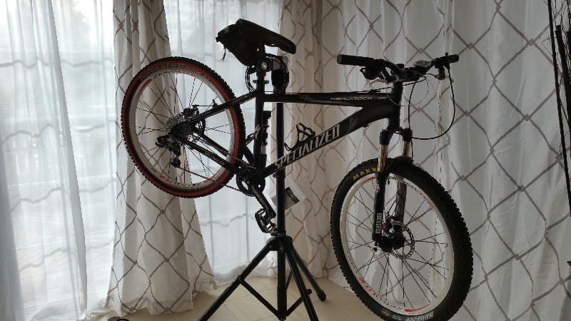

Dusted off my trusty hard tail and converting it to a 1x10.
