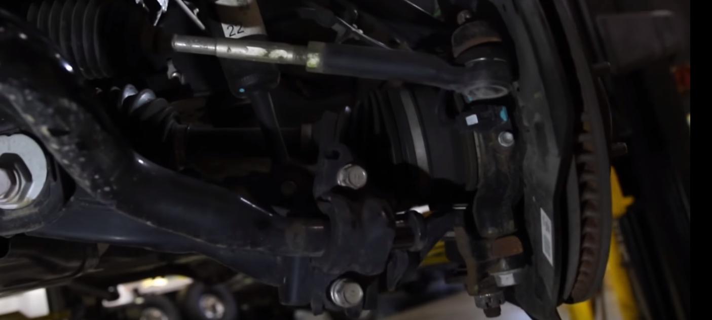

Any one know the torque spec for sway bar LCA link w/kdss?
cicio
It's the lower two bolts in the pic.

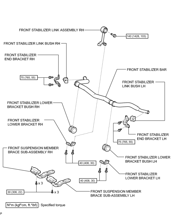

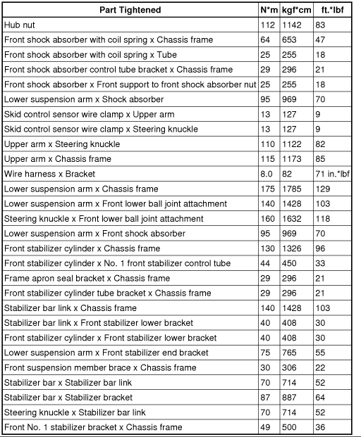

Here's what I can see in AllData for my 2015, I assume 2019s are the same setup. Let me know if you guys can't see the images.
Front suspension
attachment.php

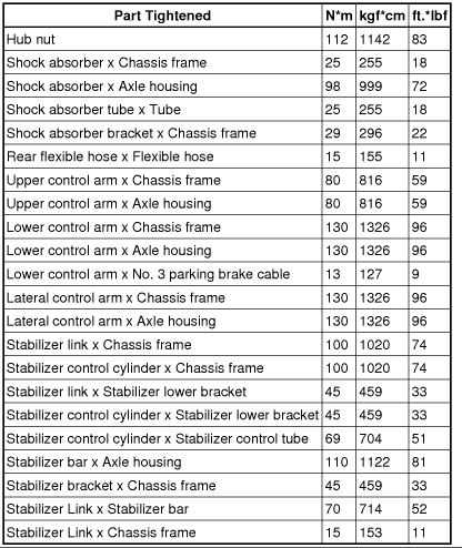

Rear suspension
attachment.php

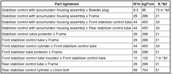

Stabilizer Control Valve (w/ KDSS)
attachment.php

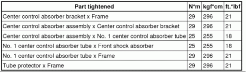

Center Control Absorber (w/ REAS)
attachment.php
