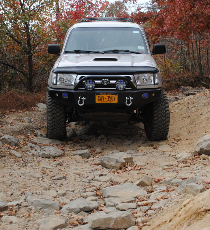

I would definitely get the clear coat. Wax it twice a year & after almost 18 years my paint still looks like this. Yes, I'm the original owner.
