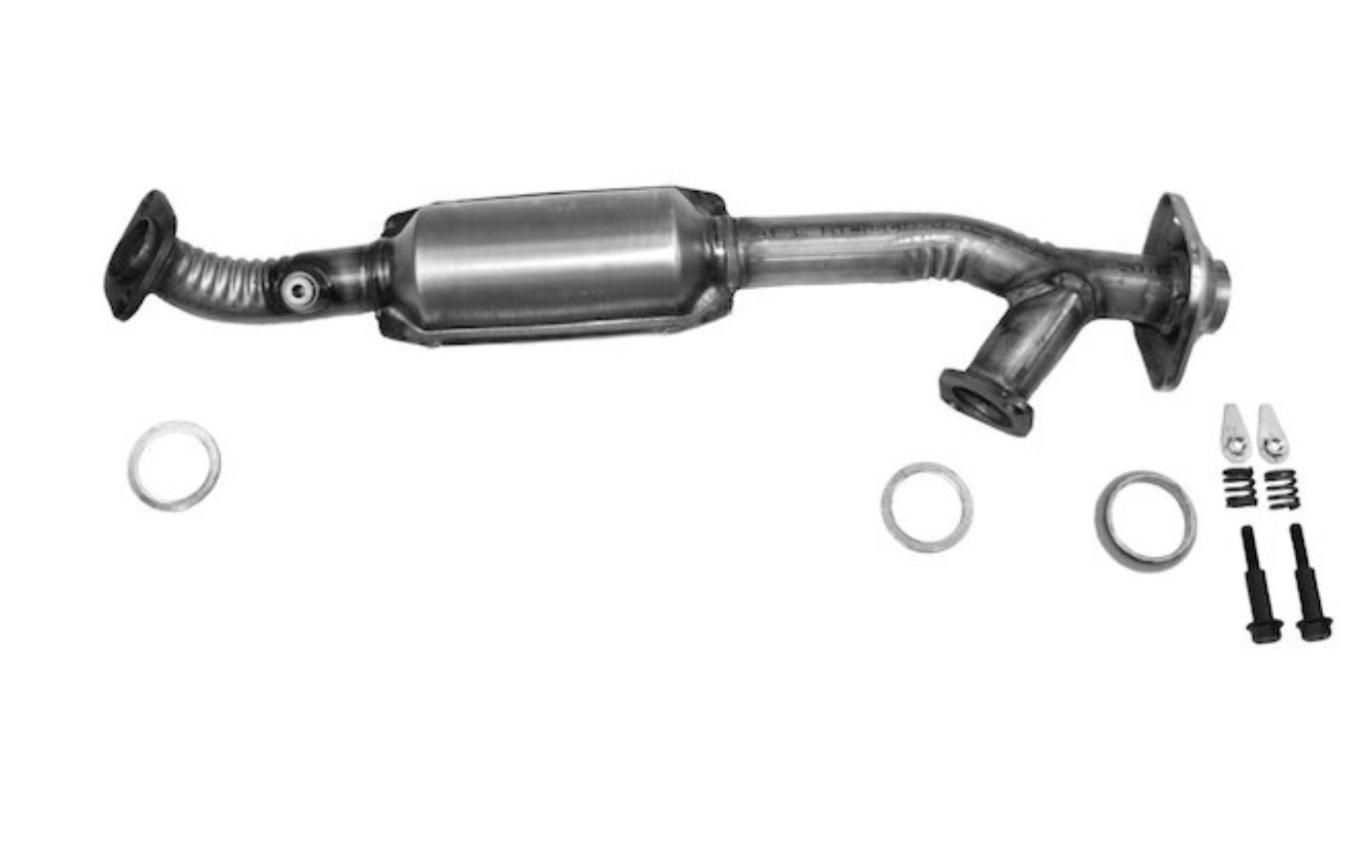

This right side part of the y-pipe with cat is made by AP is only $295. Add the left side for around the same and you get a full y-pipe for $600 with no welding.
My question would be fitment and quality. I'v had those issues on exhaust stuff before and it's no fun.
Any one use the AP y-pipe as a replacement on their 4th gen?

What you've posted is only the rear section of the CAT system, correct?

That's correct - only rear section. And to clarify, only the passenger side has a second cat on that side? The driver's side after the manifold intergrated cat is a resonator, not a cat correct?
I ask because the aftermarket y-pipe configurations I've found sell the passenger side AND driver's side section of y-pipe with cats on BOTH sides. Which seams weird if OEM is indeed just the passenger side second cat.

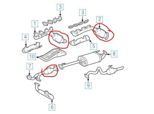

I'm in emissions state as well but mine came with three cats as shown below!! I can't imagine where the 4th cat lives!
