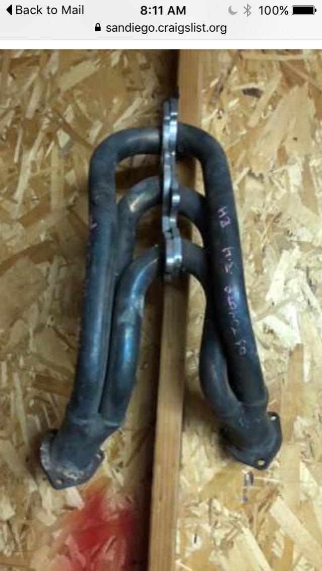

Resurrection time. I can't start a new thread as I am a noob. I've been lurking for a couple of years though as I own an 03 Extcab Taco 3.4 m/t and ever since have wanted a t4r. That red coolant got in my blood. So now I just picked up a 96 SC 3.4 m/t with suspension mods that are pretty sweet.
Anyways I just got a line on a pair of headers that the owner had on a 00 limited manual. He's not sure the brand but thinks they are DTs. I wanted to post a picture to see if anyone could help ID. They don't look like the DT shorties and they have that triple flang. He wants $200 and the drive is 6hrs r/t. I know I can buy lower line ones for a few $ more so... I know some of you have seen a lot in your travels so any help would be greatly appreciated. Thanks and very glad to be here.
I have no idea what brand those are. I'd be wary of fitment. They are not Doug Thorley, OBX, or TRD headers, those are the only brands I know of.
