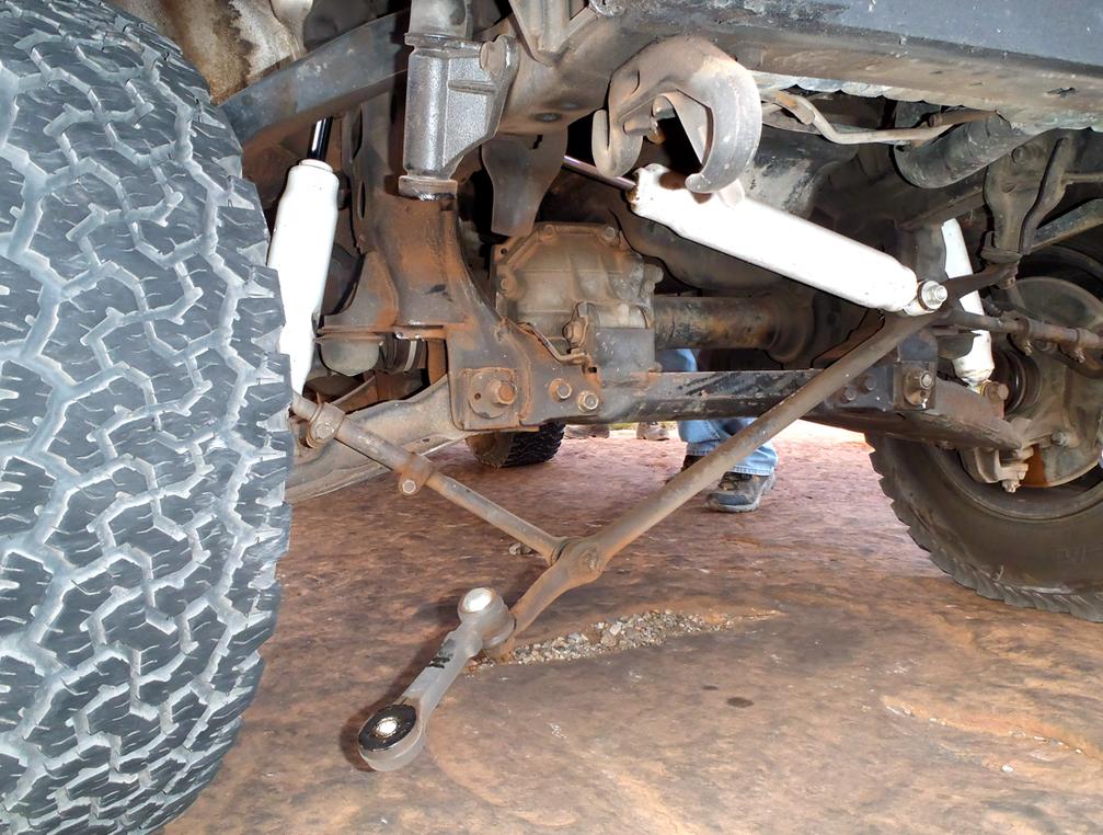

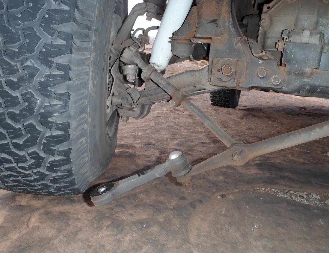

I just fixed my idler arm a couple weeks ago by replacing the bushings. I followed this guide:
http://www.4x4wire.com/toyota/maintenance/idler/
It was fairly easy, just make sure you get the right part numbers. It took me four hours of going through all the stages of grief to figure out they gave me the wrong bushings. Once I got the right ones it took about fifteeb minutes to get everything assembled again
