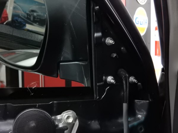

Actually in the midst of doing the stereo so here's a pic of the mirror.
Lift the elbow pad off (snap on) and then remove screws behind handle and door handle pull.
The rest of the door panel is just a snap in.
3 bolts hold the mirror.

Elbow pad is a snap in. Lift up to remove.
One screw behind the elbow pad.
pop out the cosmetic trim behind the door handle.
There's one screw securing the door handle.
The entire door panel is snap in so pull gently an off it comes.
Remove the trip over the mirror to expose the 3 nuts.
Tighten and then reverse the order.
