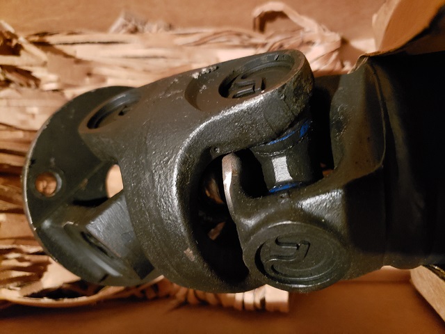

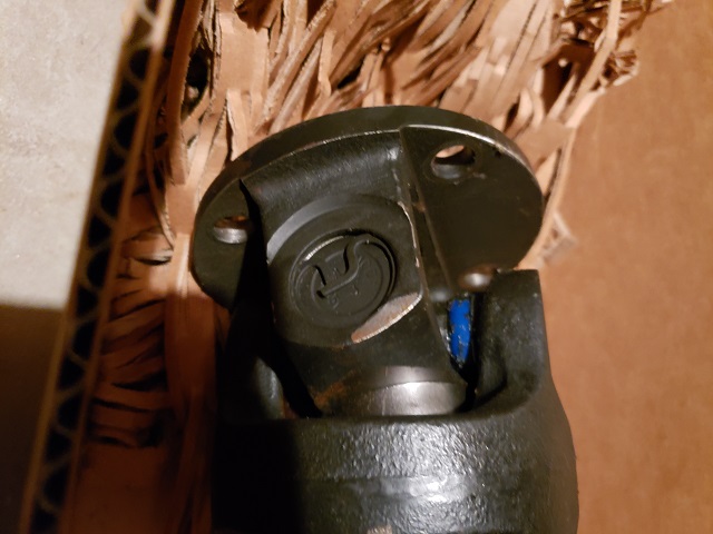

See pics of the fresh out of box DC ball and my notes. The aim is retaining the proven oem quality shaft with high quality replacement parts to the level of oem long term performance. I cannot tolerate low quality parts with my heavy use of 1,000 miles per week. Junk parts reveal themselves too soon.
I posted the parts used on my rebuilt shaft which are reputable as high quality driveline parts by Neapco, they've been around 100 years. A good driveline shop will absolutely know what is junk and what is high quality.

i missed that post. So, you said that Neapco makes the center ball. Are they also the supplier for the u-joints? I'm guessing they are because you show a picture of a Neapco u-joint box with a part number. Is that the part number for the u-joints they used for your rebuild? Do you have a part number for the Neapco center ball?
Update, I looked up that part number on the box and it's the part number for the center ball. If you could hook us up with the part number for the u-joints they used, that would be helpful.
It was a few months ago, but possibly the 3 standard U-joints were the same company.
Ok. The rear u-joint is easy to find because Toyota makes it. The ones for the double cardan joint are quite a bit more mysterious. I think Moog supposedly makes some that will fit. If you're willing to contact the shop that did the work for you and ask them the brand of u-joints they used for your rebuild, and better yet, obtain part numbers too, it would be appreciated. If the u-joints are quality and the center ball is quality, then it's worth rebuilding them.

The DC U-joints are standard joints, its the cradle between them that has a cup and small shaft for the ball that does the trick. Here's a couple pics of an aftermarket driveshaft in my basement for an easy visual. See the standard U-joints and see the loops of the cradle that holds the ball, fairly simple. The tiny ball shaft thickness is what they measure for wear. My ball shaft was still good after 300K+
You can crawl under your rig and see what I'm talking about.

Of course I know about your Youtube channel, I even suggested to you before you do a video on double cardan rebuild. Well I did some online search and came up with little on actual part numbers on the DC U-joints. They are standard U-joints, but of course you need the right ones. Personally its not something I would mess with cause my local driveline shop is a reasonably priced complete rebuild with balance with quick turn around for only $235.
But there are the few that would like to tackle it themselves. I think if you have a spare shaft laying around (if you were local to me I'd give you one), break it down and verify fitment and document everything that seems nobody has posted online.
The ball part number I verified one from Neapco 7-0407 you can get one here, pricey $43.75
Northern Drivetrain, LLC: Neapco 7-0407
I'm gonna assume you can get all the U-joints from them also and you can ask them part numbers, but after all the distributor markup....in the end best to source best price.

Ok, the driveline shop is right down the street from me, so I went to talk with them. Cool guys, seem always willing into share info. The guy said they use Neapco or Spicer U-joints on all their shaft rebuilds. He said there is not really any documentation on the 3rd gen Double Cardan U-joints (as we have found also), and he doesn't know off the top of mind. But the way he can tell what joint it is, he measures it at the points I sketched on this paper, he said also some U-joints have inner C clips. He said that the Neapco 1-1612 part number popped in his mind, but wasn't sure on that.
I'll be rebuilding another shaft with them for my other project 3rd gen in a few months. If you don't tackle the DC by then, I'll be sure to get the part numbers for you.
