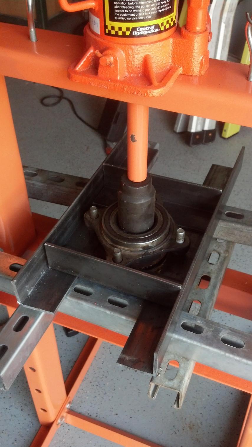

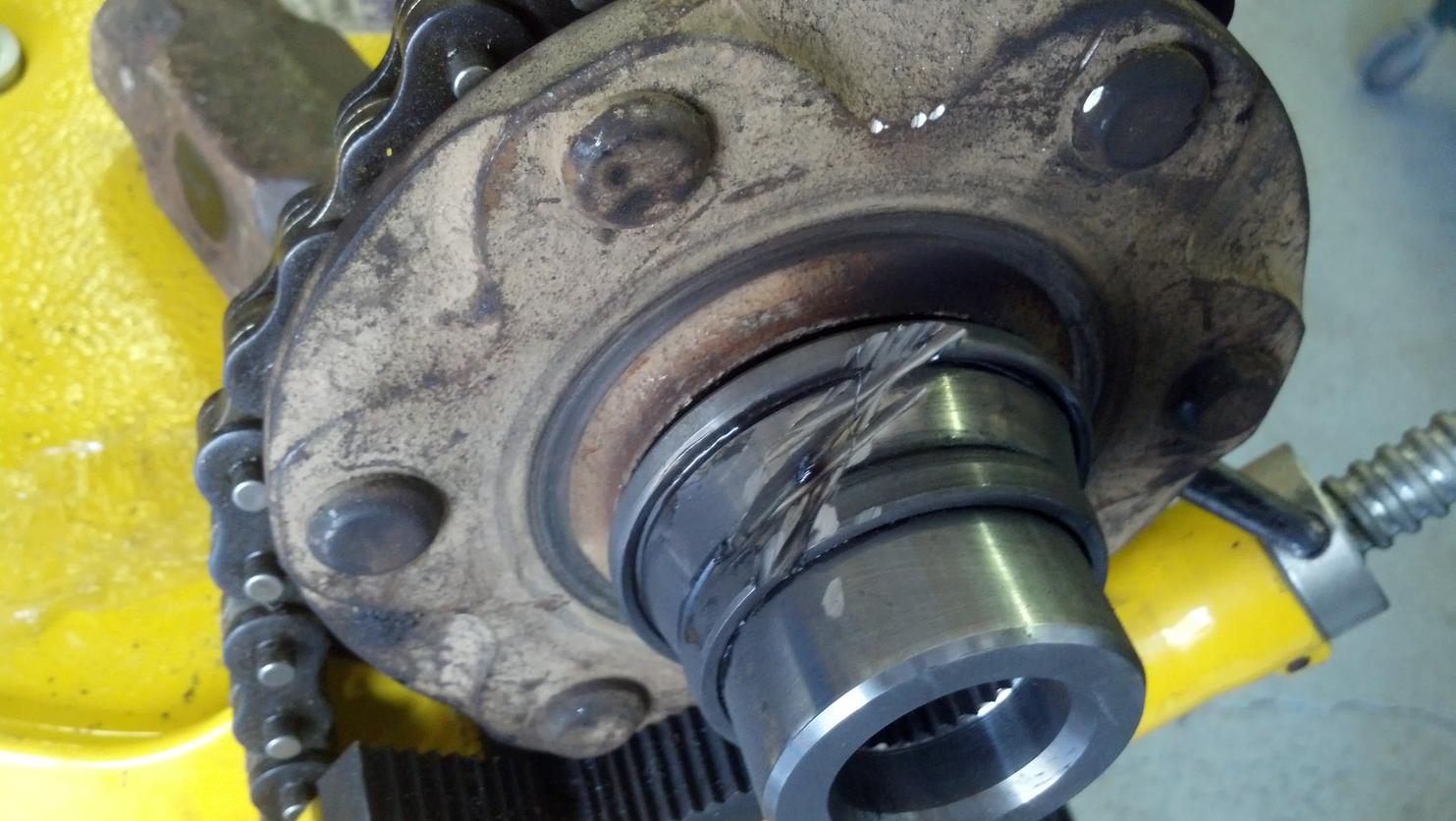

This is how I set up the press to get it apart and then clamped it in a pipe vise to get the old race off with a cutting wheel. Had to Mcgyver it a bit but it worked great. Ill find the picture of how I pressed it back together too.
Nice setup there to ease in removing the old hub. The second picture does show what I was talking about on wear on the hub. If you look you can see a slight wear ring where the inner seal has been making uneven contact with the back of the wheel hub. That one is not that bad, and could probably be buffed out with some emery cloth, but I have seen many others that were a lot worse.
