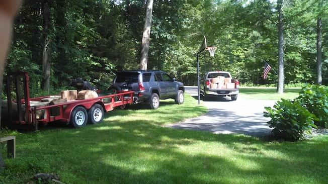

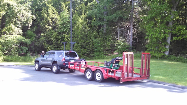

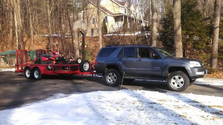

As for what you're towing, I've used mine (04 v6 sr5) to tow 3 atvs, firewood, lawnmowers, etc. it handles it well, just balance and secure the load properly and you'll be fine, trailer brake controllers make a world of difference, as do the airbags, someone who has those would be [MENTION=44862]macoyle[/MENTION]
in the pictures i attached, the first two i have 5100's and icon rear 2" springs, the last photo is stock suspension with a 3/2 spacer lift

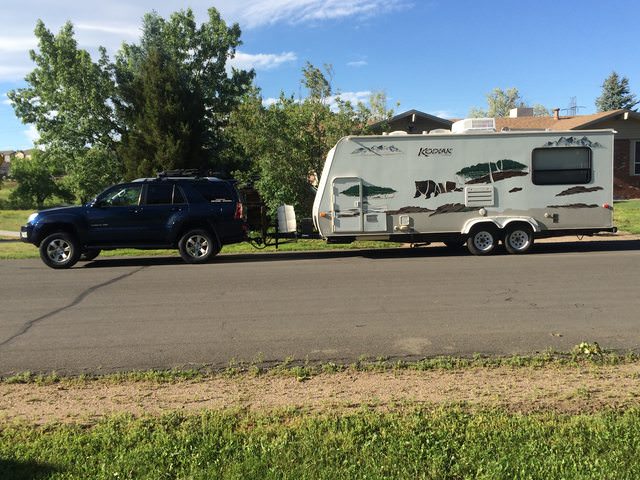

I pull a 25’ ( tongue to bumper) 5000 lb+ travel trailer about 6 times/ year. I went with an OME 885/Toytec RCC2.0HD combo with the recommended OME struts. This gave a 3 x 2 1/2” lift with a decent ride I’m usually loaded with gear so the added weight helps and it works great for off roading too! I run a Curt WSD hitch and as I have the towing package with my V8 I have the tranny cooler, better hitch and it’s prewired for a brake controller. I still have my Airlift 1000 airbags which I ran with stock springs and a Daystar lift, however I don’t inflate them for towing as they’re 1-2” short with the new springs.
