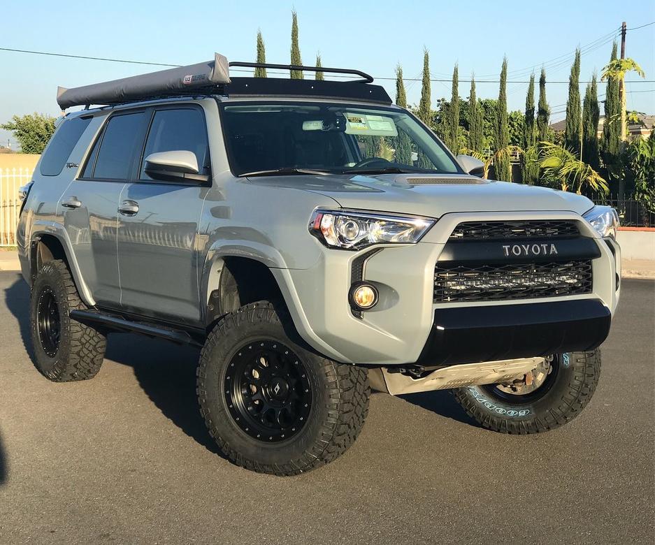

My front is set to 2”. I’m still under 6’6”. It gives a little extra clearance without excessive preload. The ride is very smooth, and the handling is excellent even without a front sway bar. If you’re looking at Kings or Icons, the benefit is travel, not necessarily lift.

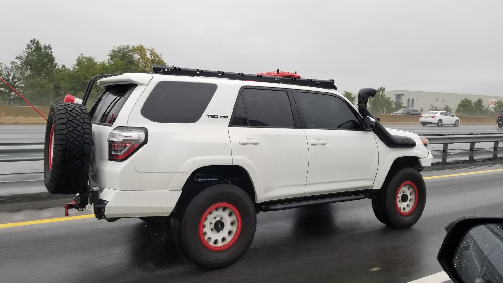

7’1” but I don’t have a factory rack. On 295/70/17 ridge grappler tires at 36 psi.OME heavy duty rear coils and 700lb king springs up front.

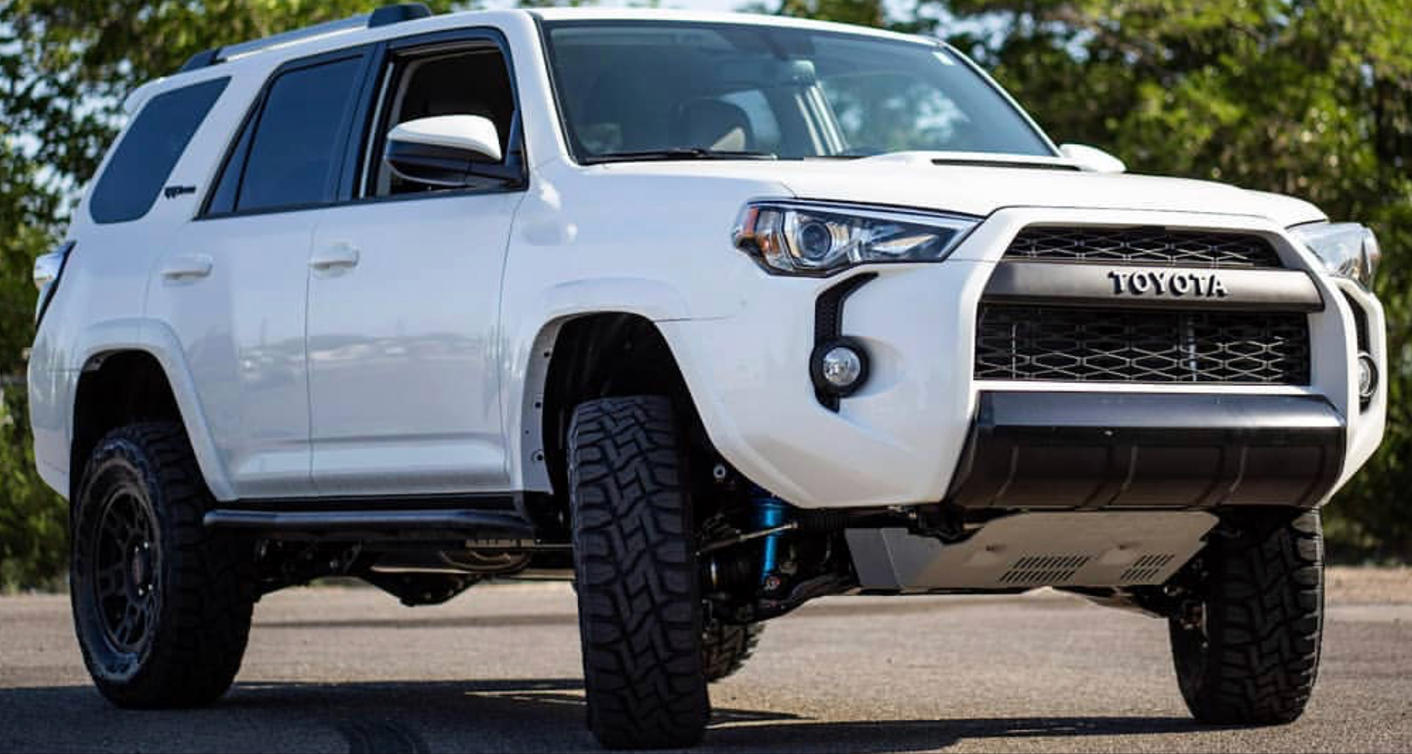

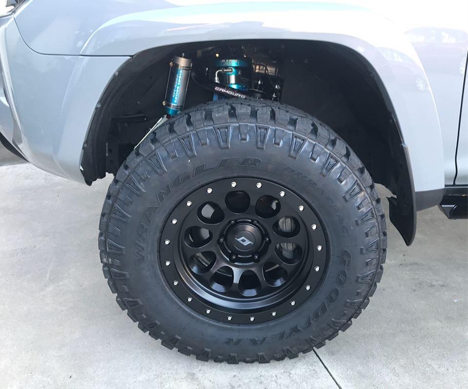

King set at 3”
