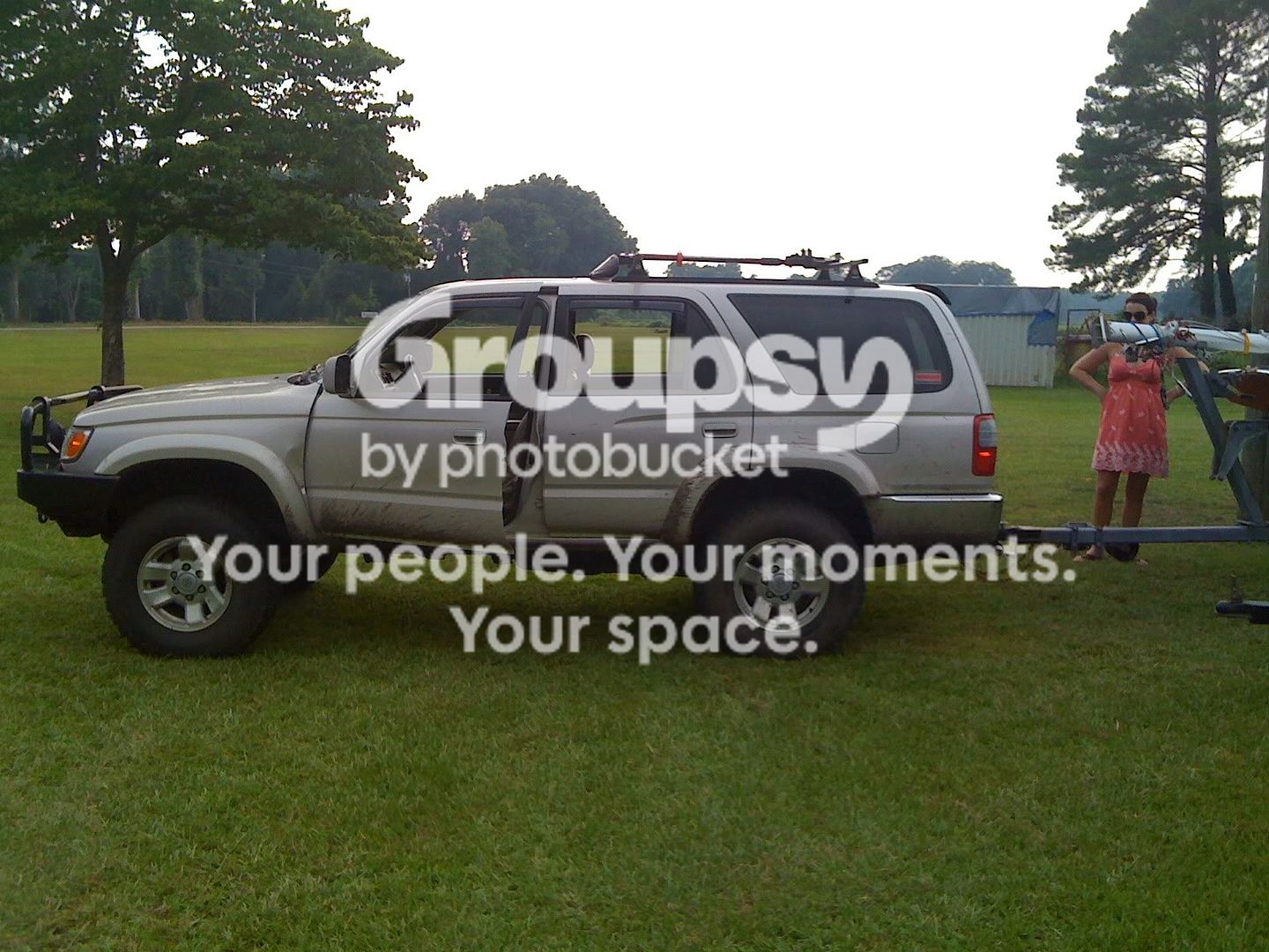

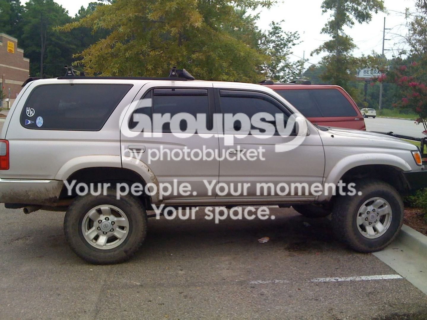

heres a couple pics of mine with a load. prob a 300-500lb load.
and yes, it sucks to cruise around with alot of weight on the LC coils.

Not quite. i have about 150 lbs extra. The 861's are a 220lb spring rate while the LC are 150. I am also a good 1-1.5 inches taller than the 8.5 wraps i had in there. Just because there are not much taller does not mean they will sag the same or more when loaded. the OME 890 and 891 are a perfect example of that.
