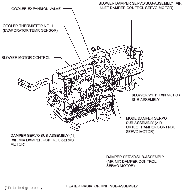

It's not a dual zone system and it does it in all modes, defrost, floor etc. I think it is a servo motor for the air mix control but I am not sure how to get to it or test it. I actually got that info from a site called justanswer.com If anyone can tell me how to find and test the servo motor I would appreciate.
Found this in an 06 manual, but I don't think it's that different on the 03.
To orient you with the location of this system, the "Blower with fan motor sub-assembly" is located behind the glovebox.
